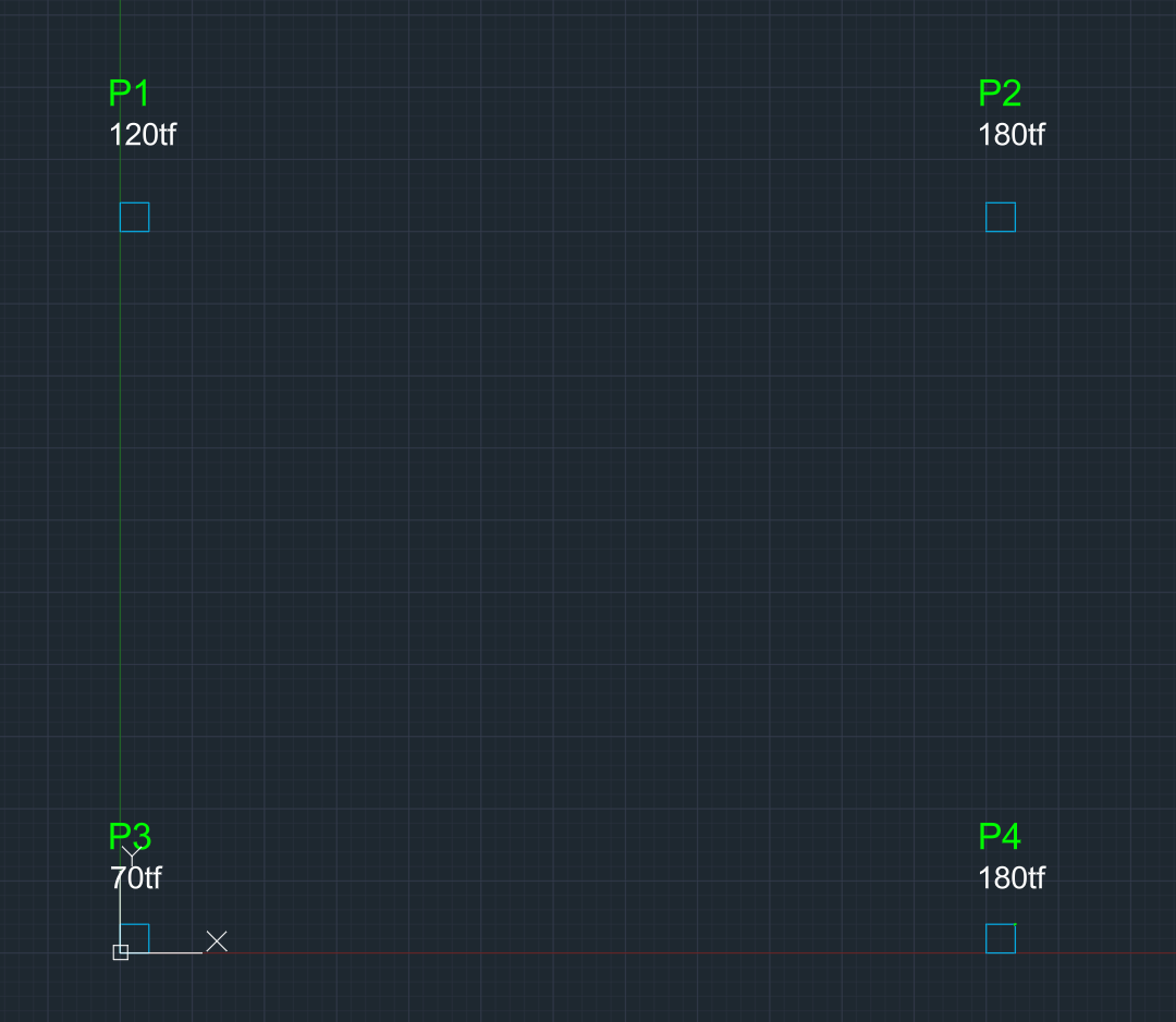

I’m a newer in a Dynamo and I’m trying to create a routine that read a geometric point of a column and the name of the column.
I get the coordenates points and create a vector. In my sample example, I have only four columns.
The order of the columns isn’t the same order to the text. So I put a value to get the minimum value of the list.
It worked but when I tested in a bigger project, this number pic two values in the same sublist. If I lower the number, sometimes any value is true in a sublist.
I’d like to keep this structure for all items need to be tested if it’s the minimum value in a boolean. This information will be used to get the correct value of the name and force of the column.

I imported the CAD file
Get the geometric point of the region and the coordinates of column names and force.
After join this informations, I export to Excel
