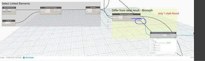

Hi all,
I am trying to replace Bakery to Bimorph due to the execution time is much faster, but I am stuck at the incorrect result.
I found out that the Bimorph clash detection node only found 1 clash which is not my ideal result, it should be 4 clashes be detected in this case. I don’t know which part I am missing. Thank you all!
Bimorph V4.1.2
Test for Wall Opening.dyn (41.2 KB)
Revit 2019:
Test for Wall Opening_1.rvt (2.5 MB)
Linked Model:
Test for Wall Opening_MEP.rvt (2.5 MB)
@Daniel_Dave , try setting this to auto
It works! Thanks Kai.
