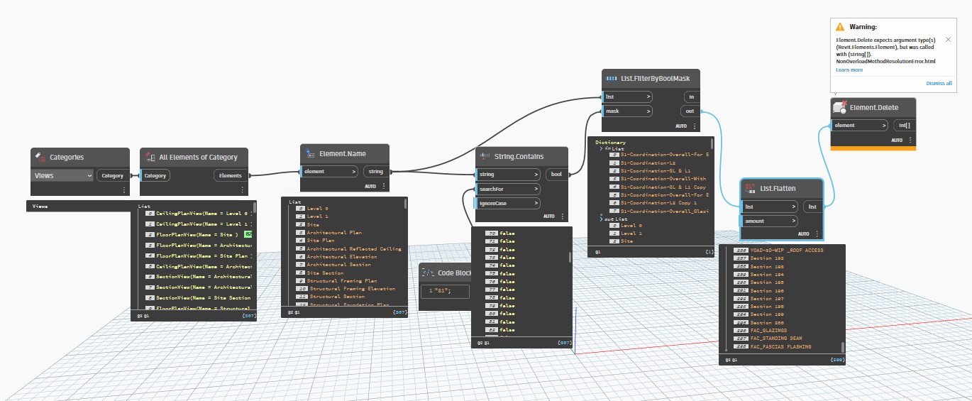

Hi guys, currently, I am working on submission and want to delete all views except 3D views. And I am getting errors. I have attached herewith the Dynamo file (2025). Appreciate someone guidance. Thank you in advance :slight_smile:
You are sending strings/names into the final node. Send the elements through the mask instead.
Hi @RaymSanz maybe try as here…edit the same as Gavin say…he was just to fast :wink: :wink:
yes, it works! thank you bro, appreciated
