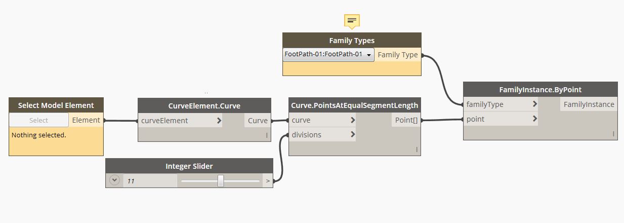

I found this while searching for a solution :
is there a way to make the family follow the orientation of the path? not fixed to x,y orientation?
Here is the code : credit to the original poster of the code.
check the edit
Thanks so much!! working fine. I added the data-shapes nodes so i can input the division values without opening the code.
I use the Y.Axis on my case BTW.
Thanks again.
