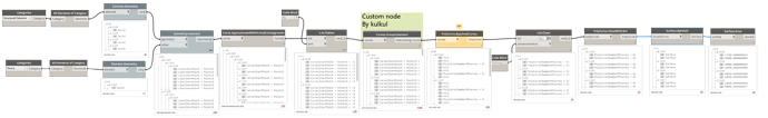

i try find area polycurves as in a picture. but PolyCurve.ByJoin is null.
i tries way find curve in 1 ref plane, i wanna find node find ref plane
I’m guessing you need to use Group Curves (from Archi-lab) to group your selections by joinable curves first. Then you can join them.
hi Nick_Boyts
i done,
then i use node PolyCurve.byJoinedCurve but error, beacause i wanna find area polyCurver as in picture
It looks like you’re short a curve in each group. You have 7 curves but you need 8 (4 for one rectangle and 4 for the other.)
I understand that, and now I’m looking for ways to get that result, you can help me.
@alibabon You could also join the missing curve by using Springs.LineLoopMerge.

I got 7 Curve and i wanna join it 2 surface as the picture.
There is file:
@alibabon Here is how you get the areas.
Thanks Kulkul.
Let me ask if there is a way to collect four contiguous Curve together, because the above is only true for one case.
I believe that’s what i showed you above how to create 4 contiguous curve together. If the Curve Intersect each other then remove the intersecting curves and close the curve.

There may be way to collect Curve in the Plane or find intersecting between Curve and face element can found list 4 curve?
Great, that’s it.
