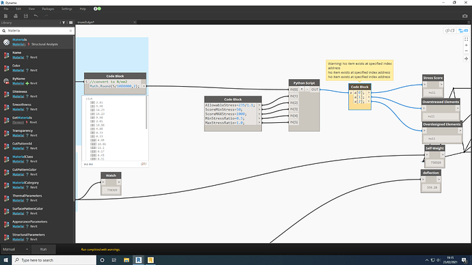

However, I have come across another problem now, which proves my point that dynamo sometimes creates errors. Everything is working fine in this script and the previous node as shown below has a list of 32 values. However, the next node has Null values. Although, I am quite unsure if this problem is related to the python script node (the list value is zero).

i’m working mostly with Dynamo studio<>Robot. and what i figured out if you use a python node between parts of the structural analysis packages, it won’t work due to the speed of the python script.

I would have to see what is happening in the Python node and a preview of that data to know what is up. My guess is that the output isn’t really a list based on the error message.

Can you preview the resulting data from the python node?
the input into the node is roughly 31 lists but the output is 0. That’s the problem.
A single zero, or a list showing just a zero? At a minimum there should be three outputs… can you link me to the graph or post it here so I can find that bit of python without having to retype it?
ye a single zero. yes you’re right there should be three outputs. I have attached the dynamo script. I am only using the “Python Script” Node, so I didn’t actually type the code. I thought that the code is already embedded into the Node.
