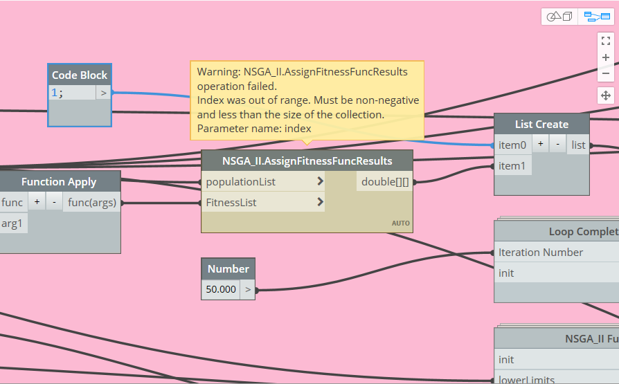

I set up the logic in Grasshopper at first, where it works great with Galapagos as the optimization solver. I then migrated to Dynamo and was able to build up the definition just fine. It works without the optimization part when I set the number of each block type manually. I then set up the fitness function and the complete definition:
But as I try to run it, I get an error message from the NSGA_II.AssignFitnessFuncResults node:
I haven’t been able to figure out what the problem is with the definition. Moreover, the number calculated by the function doesn’t seem particularly small.
