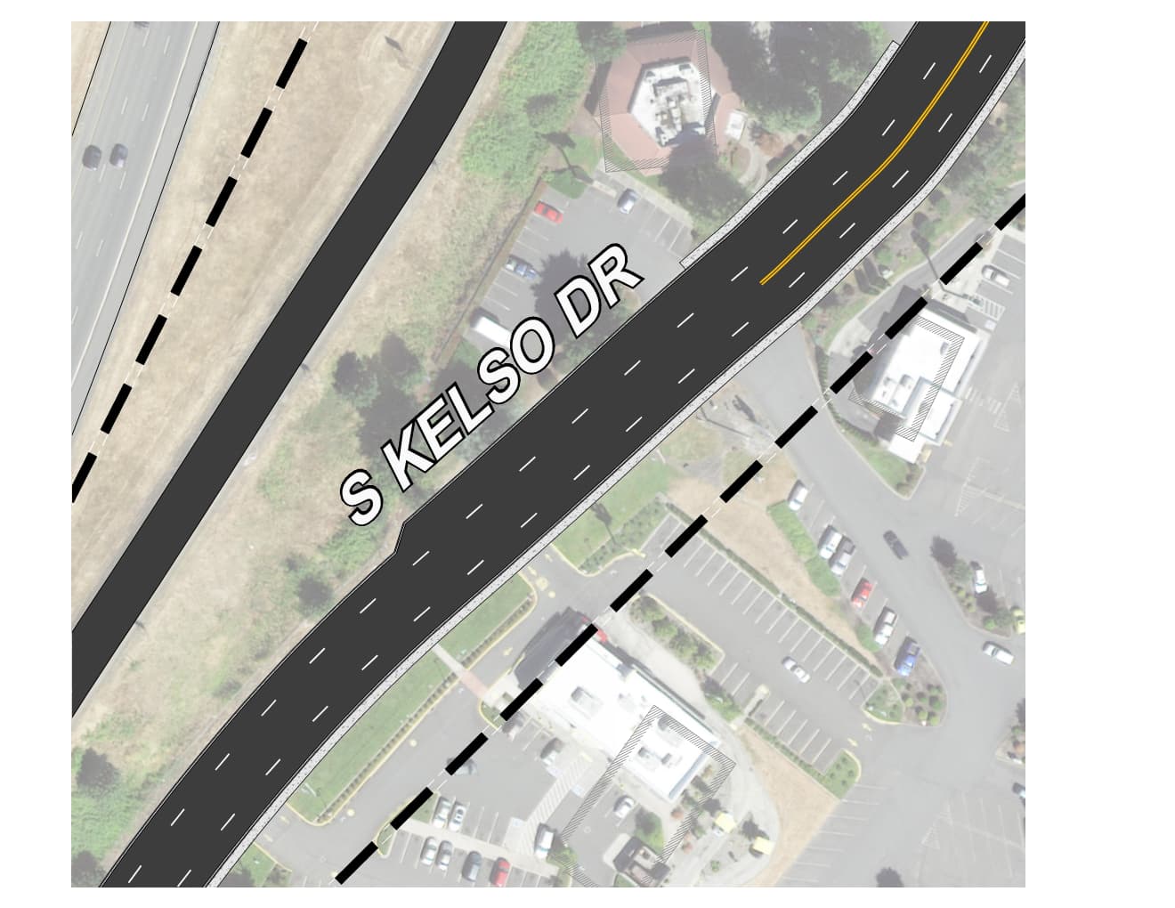

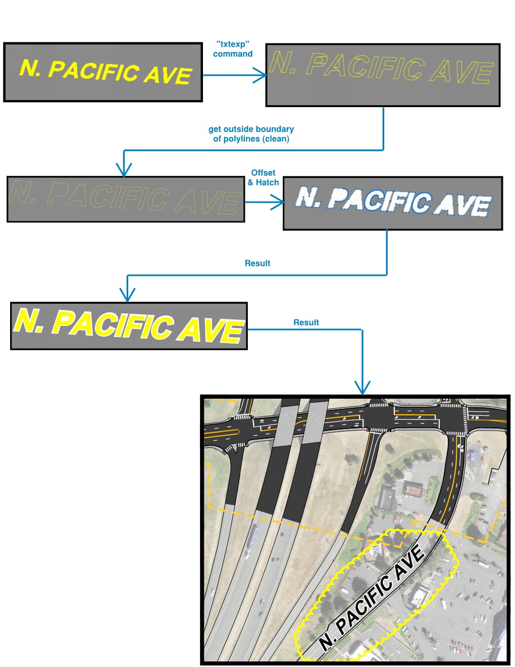

I often make exhibits for grant applications that include street names and a colored imagery underlay. I find that black text looks best with a white halo effect when placed over imagery. I’ve attached an image describing the steps I am attempting to script. I’ve been hitting a wall with trying to script it in dynamo and don’t seem to be getting anywhere. I was wondering if anyone had any ideas.
My current idea is:
1.) Copy text in place.
2.) Send “txtexp” command to civil 3d to create polylines from the text.
3.) get the boundary lines from each letter.
4.) Offset and hatch the polyline boundaries.
I ran through the process once manually to provide an example. It seems that the “txtexp” command generates lines randomly between some letters and does not immediately provide a clean outside polyline boundary, which may become an issue.

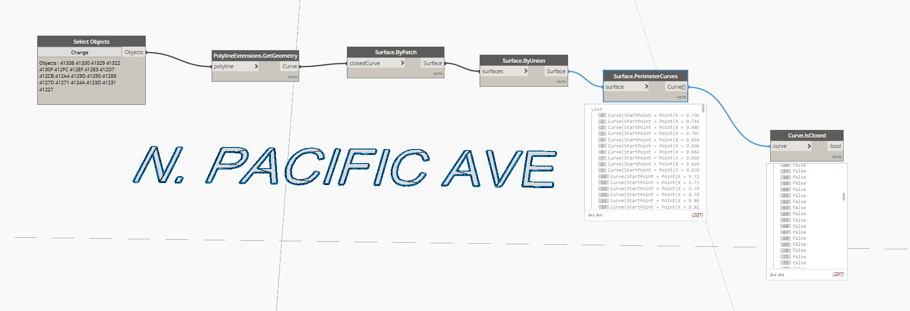

So it seems that first the text has to be exploded with “txtexp” command. Then, I tried to use this linework, but the linework was returning “points are not coincident” and some portions were missing. I found if I converted the 2d polylines to 3d polylines, that fixed the issue. I’m able to use surface.byunion and surface.perimeter curves, to get the perimeter curves; however, they are not closed and I seem to be unable to close the curves with the PolyCurve.ByjoinedCurves node. When I try to join them I get “curve join produced more than one WIRE in polycurve”. I noticed the following thread fixed that issue by using a custom node; however, that node only seems available within dynamo for revit? → PolyCurve.ByjoinedCurves warning: Curve join produced more than one WIRE in PolyCurve

I’m realizing that the reason the code in the above forum post works, but this graph fails when trying to use the “PolyCurve.ByjoinedCurves” node, is because the curves are not grouped by letter. I need to find a way to group the curves per letter. I’m guessing finding shared start and end points may assist in this.

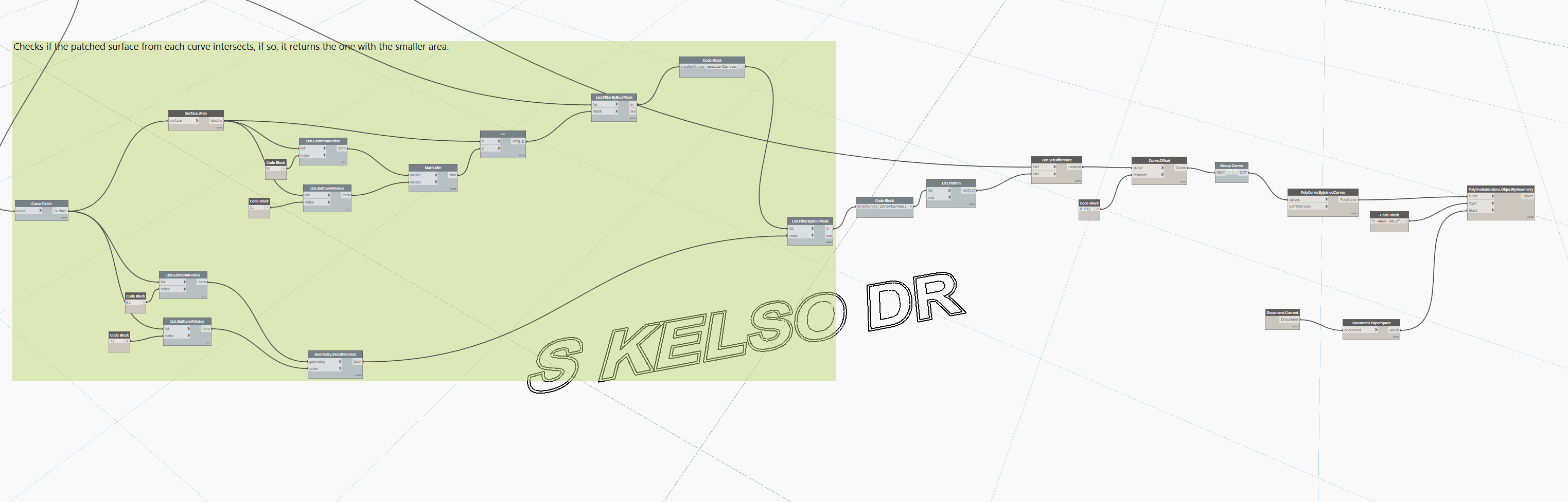

I believe it is now functional. I separated out the inner curves by finding the pairs of curves that had intersecting patches and then returning the ones with the smaller area.
The finished script is attached in-case anyone wants to re-produce this effect on their text.
TextHalo.dyn (114.7 KB)
