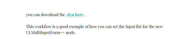

can not find the file
Which file are you referring to?
From your above link
I only posted the link to the site, i have no idea why its not working.
But the site gives you all you need to recreate it
