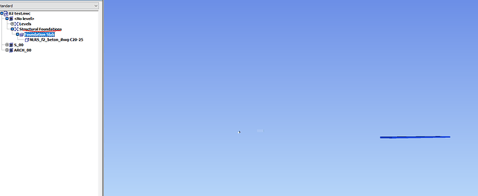

probably, i talk about familytype
The name does not appear in Revit but the export to IFC/NWC looks ok
great, then its just another question from the original
