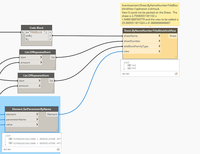

Hi there, I’ve been trying over and over but the result is still the same… I can’t manage to add automatically a ScheduleView to a SheetView with Dynamo.
In a word, what I want to do is not to dragg an drop every ScheduleView on my SheetView but add them using the node Sheet.ByNameNumberTitleBlockAndView. But although ScheduleView are views, they don’t seem to be supported by this node because it constantly warns me about the fact that the ScheduleViews are oversized.
However, I can still insert them manually, so why can’t Dynamo? The unit used in the message is feets. I already tried the Sheet.ByNameNumberTitleBlockAndViews node (same with an S at the end), but the issue is the same. Any idea guys ? I’m sure I am not the first one who try this kind of stuff.
