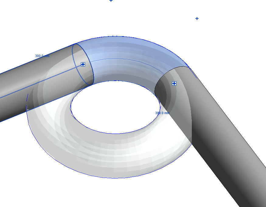

I am currently doing calculation of surface area and I noticed that for some duct fittings, the faces that dynamo is extracting is different from the actual surface of the 3D model.

Dynamo faces super imposed on the actual model

Hi @blsalvio its a bug, it’s depend of the type of your family instance and the detail level asked, but maybe you can build your duct fittings geometry with the workaround of @Kulkul and then get the face, or you can get the shape of duct fitting by Rhino inside…
Cheers
Revit/Dynamo Geometry - Duct fittings - 1/4 doughnut Revit vs 4/4 doughnut Dynamo (Torus)
Hi @paris
thank you very much for pointing/confirming that it is a bug and guiding me on the solution.
