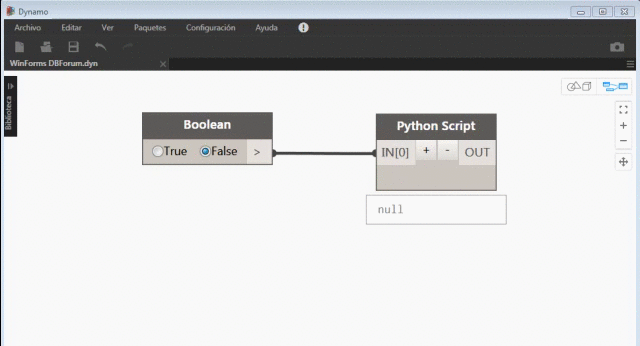

I’m a beginner in WinForms, but this should work:
clr.AddReference("System.Windows.Forms")
clr.AddReference("System.Drawing")
import System
from System.Windows.Forms import *
from System.Drawing import *
# Create a Class Form
class CreateWindow(Form):
    def __init__(self):
        # Create the Form
        self.Name = "Create Window"
        self.Text = "Create Window"
        self.Size = Size(500, 100)
        self.CenterToScreen()
        # Create Label = label
        label = Label(Text = "Property")
        label.Parent = self
        label.Location = Point(30, 20)
        # Create TextBox = textbox
        self.textbox = TextBox()
        self.textbox.Parent = self
        self.textbox.Text = "Give Up Value"
        self.textbox.Location = Point(150, 20)
        self.textbox.Width = 150
        # Create Button = button
        button = Button()
        button.Parent = self
        button.Text = "Apply"
        button.Location = Point(400, 20)
        # Register event
        button.Click += self.ButtonClicked
    # Create button event
    def ButtonClicked(self, sender, args):
        if sender.Click:
            self.value = self.textbox.Text
            self.Close()
if IN[0]:
	form = CreateWindow()
	Application.Run(form)
	OUT = form.value
Saludos.
