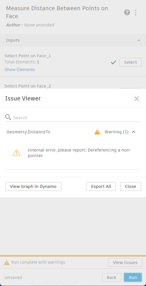

One is to measure between two points on a face. Four nodes - Pick Point on Face x 2, Geometry.distanceto and a watch node.
This runs in the editor and it gives me a result. When I try to do the same in the player, it runs but with errors and gives me a null result. I have configured the point selection nodes as inputs and the renamed watch node as output.

Hello all, if this is the Select Point on Face node, then selecting a point in Player works, but running a graph where this node is set as an input does not and is a known bug :bug: with the serialization of the node and unfortunately non-trivial to fix. It’s on our to-do list :pray:
If this is paramount to get working right now, can you utilize an alternative method for selection?
