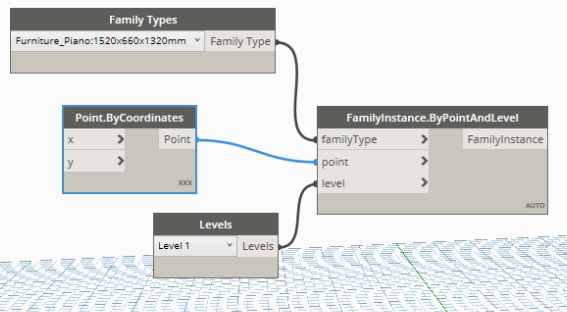

There are dynamo nodes to translate the dynamo into Revit.
FamilyInstance.ByPointAndLevel for example.
Thank you for your reply.
This sample worked out but when I create a twisted tower, the tower disappears from the Revit project after closing Dynamo.

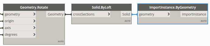

Sorry, I am not allowed to attach file so I senf a link to what I have done:
Thank you.

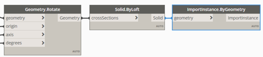

It worked out but it is passed to Revit as a symbol. The levels that were created on Dynamo are not visible and I can not add walls. Can I import this as a conceptual mass?
Try running the script in the create conceptual massing modelling environment.
Thank you.
It worked out. I can add walls and window but roof or floors.
