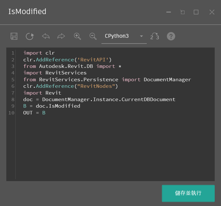

I have tried using Python to import IsModified Property of Document Class.
But after modifying the RVT model, regardless of whether I save it or not, the return value of the Python node is False.
In addition, Python also reported an error when introducing the HasAllChangesFromCentral and GetChangedElements methods.

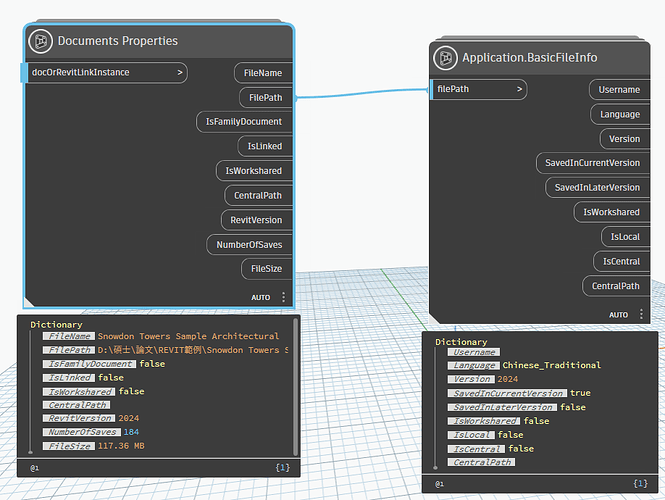

I also tried to use Dyn nodes, but the results were also strange (SaveInCurrent always returns true, SaveInLater always returns false).
IsModified Property

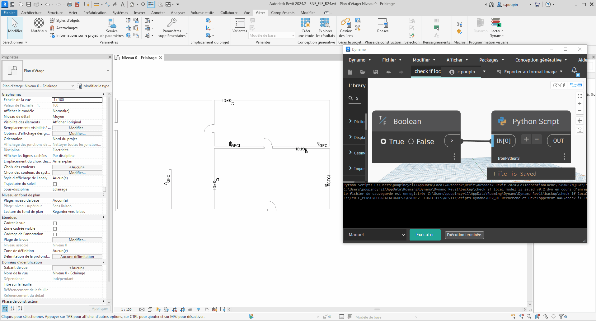

Thank you for your suggestion, but the python node still reports an error.

The picture above is the result of directly pasting the program code provided by @c.poupin onto the PythonScript node intact. So my question now is, if the Document is not workshared, is it useless?
