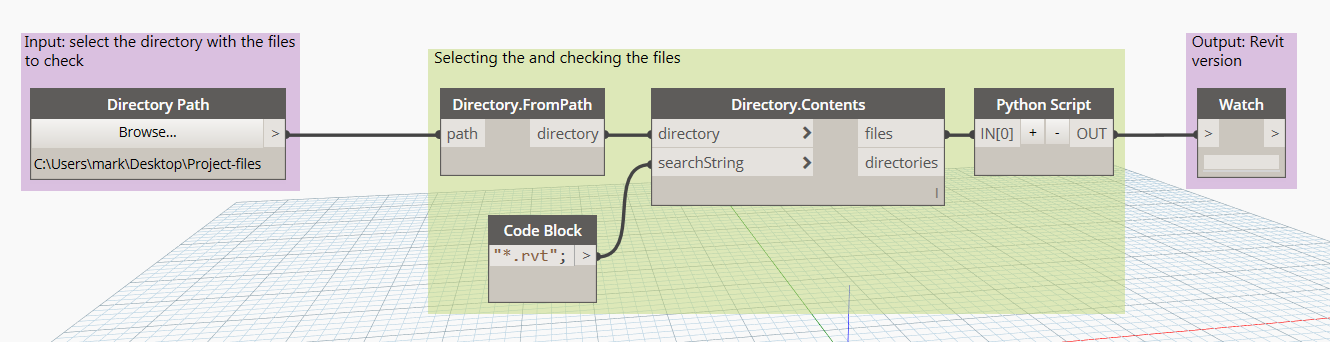

Do you mean something like this ?
Revit version rvt-files_by directory.dyn (5.7 KB)

Morning Mark,
considering the watch is empty itâs hard to know but
Iâm after the build version ( 20170927_1515(x64)) the version is accessible with clockwork
Sorry, this Python script wil only give you âAutodesk Revit 2017â.
Maybe it can be edited to suit your needs, but thatâs not my cup of tea
