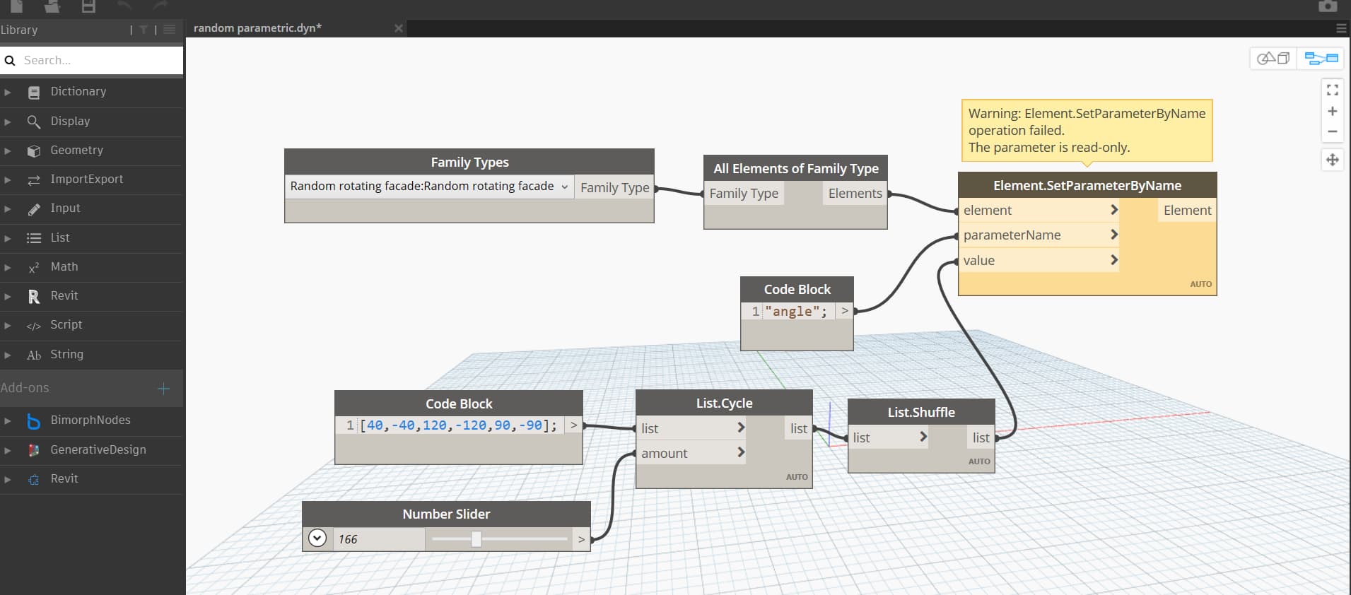

I am writing to ask for your help with an error message that I am encountering while working with Dynamo in Revit. I am new to using Dynamo and have been following some tutorials to get started.
However, I have come across an error message that I am unable to resolve. Specifically, I am receiving the following error: “Warning: Element.SetParameterByName operation failed. The parameter is read-only.”

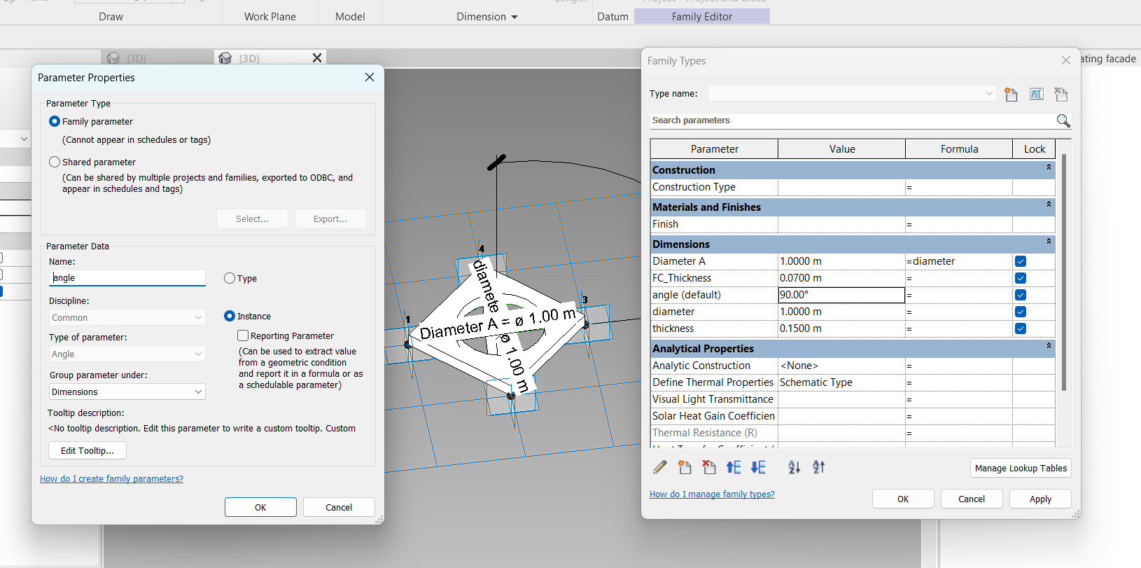

I created the family myself in Revit and I am certain that the parameter exists inside the family. Despite my efforts, I have been unable to find a solution to this issue on my own.

family screenshot

@ilyass.hlioua this is a Revit warning stating that the parameter you are trying to change is Read Only. I know your screenshots show that it is not in fact read-only, so it’s a little perplexing.
Would you be able to upload your family (No need for project) so that I can test? I’ve upped your permissions to do so.
You won’t be able to modify the adaptive component parameters outside the massing editor. Unfortunately, there’s no API for handling the massing editor so you can’t automate this within the project environment.
If you watch the tutorial carefully you’ll see that they’re actually doing this for a massing family (in the family editor). Dynamo should be able to modify the parameters there.

That might be something you want to look into if you’re going to be using massing. You can have an in-place mass or a loadable massing family. They are similar but not interchangeable. You have to use a loadable massing family for the adaptive components to be modifiable in the local (family) environment.
As for your videos, the first one doesn’t show how the massing was created or if it’s even a massing family to begin with so it’s impossible to say what they’re doing. The second video does the same thing as your original link in that it uses a loadable massing family between the adaptive component and the project environment.

You can’t. You can only modify those parameters in an “editing” environment. That’s not possible in a project due to API limitations and why you have to do it within the family environment.
You would have to use Dynamo to open the massing family, make changes, and then load back into the project.

I don’t know what to tell you. It may be a bug or fix in a later patch, but this just doesn’t seem to work anymore. I can’t say what they did in the video (there’s an edit between running Dynamo and showing the modified result) but Dynamo does not run inside the edit mass transaction from what I’ve seen and tested.

  1. Your “Random rotating facade.rfa” family looks to have some issues inside the Revit family where, depending on the size of it, it’s not going to work as some geometry isn’t locked. Two examples below - a big one, and a small one.
  1. It does appear you have a correctly set parameter when this family is loaded into a Revit project of “angle”. Manually changing this works to rotate your circular disc.
  1. It also looks like Dynamo can correctly set this parameter if its in a Revit project
