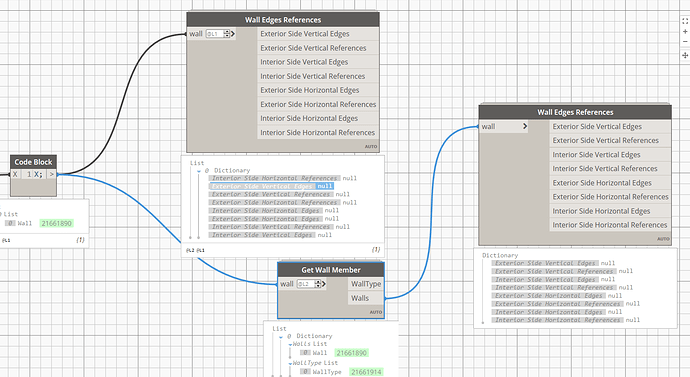

I want to get Reference of wall, i try to Wall edges reference node but output is null.
please suggest me how to fix this.

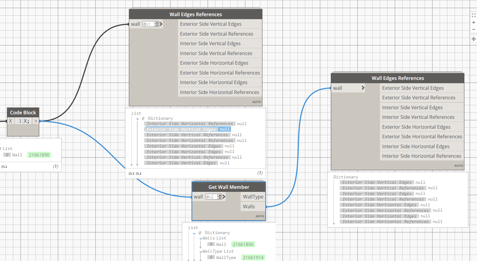

Hi @robert12546358,
What kind of wall is it ?
The Wall Edges References node works with linked walls :
Thanks for reply,
Its just a simple default wall, and also I want side wall reference (left side and right side of wall)
Is the Genius Loci package up to date ?
Does it work with another random wall ?
I use a Basic wall.
I have never encountered this error with a basic wall.
Can you share your Revit file?
After restart Revit its works fine, but I cant find a way to get the side wall reference (right side and left side of wall)
