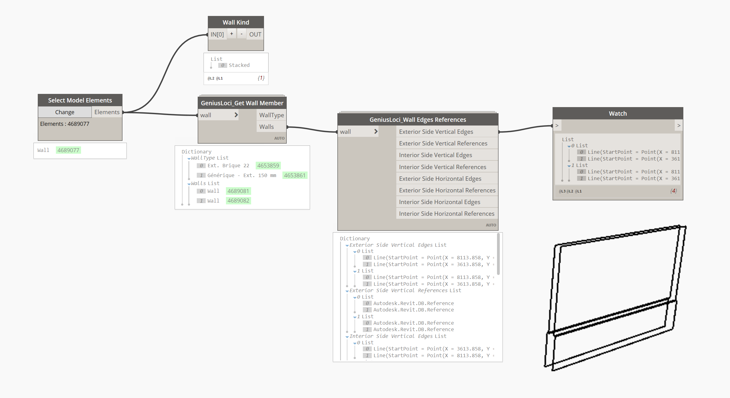

Sometimes when I use a script to auto dimension the exterior side of a wall type, the Wall Edges References node from the Geniusloci package is giving a list with null values… Anyone knows what could be causing this?
Edit: I found out it’s happening with stacked wall types… Any way to find the exterior side of a stacked wall with Dynamo?
