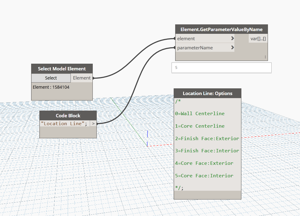

I wanted some guidance regarding the Wall Location Line type in Revit. Is there any script or specific node or package that helps to detect whether our model’s wall is drawn based on center-line or exterior face or etc?
I tried Lunchbox wall collector, but I need an output string like " Center-line" not coordinates of the line.

@arghavan.A try this:
Thank you so much @salvatoredragotta!
It worked, but how did you brought up “Location Line: Options” node?
That was just me writing down the different options in a Code Block
