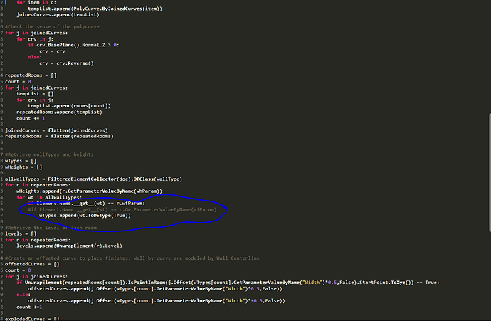

I want input finish wall in Dyanmo.
But I couldnât edit code in Python.
Could you tell me?

I have tried the Modelical Node in 2019v Revit and 2.0.3 Dynamo, it returning null in output and nothing is creating. Can you help me on this Please?Wall Finish Pro.rvt (1.6 MB)

I tried it and the message disappeared but itâs still not working. It makes ânullâ when I run it. Itâs weird beacuse in my old computer I used the same routine and nothing happended until now.
Copy the Python node into the main workspace, and run that on a single item. The node should provide some direction in terms of why it is failing.
I did and nothing happen, watching other blogs I noticed the âRoomsâ is a class name and I can´t change it as a variable. The problem is, when I change something like âroomâ in the node, it doesnât work and I donât use python to change the script or something to fix it. If you know what can I do please let me know.

Can you help me to solve this. It is working in 2019v Revit and Dynamo 2.0, but the error caused in Revit 2022 and Dynamo 2.10
I am not good at python
