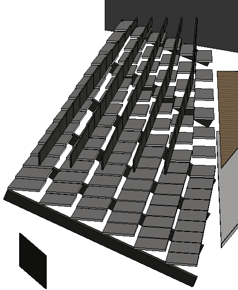

I’m trying to create walls that are placed at different levels.
I was expecting that it’d work like the floors where even if I placed the level at ‘e.g. Level 2’, revit automatically computes the offsets for me in order to place it where I want it to be.
What happened instead was that all of them were created at certain level. Any idea how to fix this?
stepped_dynamo
The walls are supposed to go here
walls_blue
Try first to play with lacing and list@level on the Wall.ByCurveAndHeight node…
Thanks! It Worked.
Just wondering why it worked though (@L1 and Cross product). I mean even if it accessed the deepest level of the list, it should still apply Level1 right? I have no idea why this worked.
