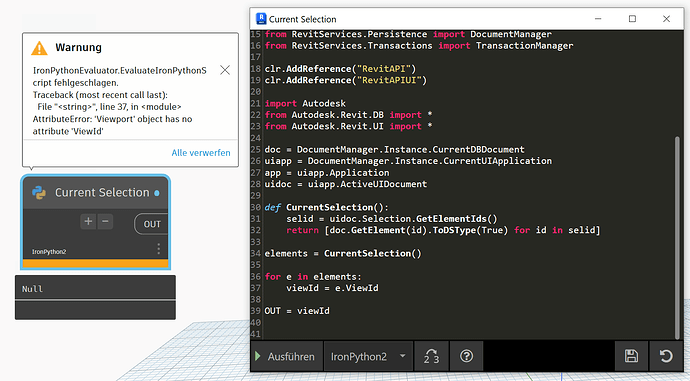

Good evening :slight_smile:
I have a problem getting the view ID from a viewport.
Had a similar problem last year, there it was the missing unwrapping.
Any idea?
try to remove the conversion
.ToDSType(True)
Cyril saved the day, again, thank you very much :slight_smile:
