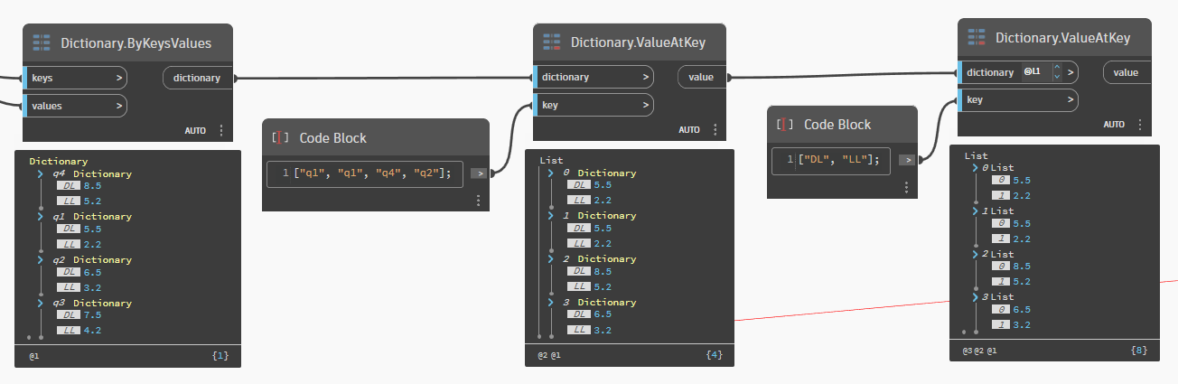

You could look at using dictionaries to call the parameter values by key
Excel example
Build dictionaries - note list levels
Then you can feed in the types as a key and get the values for the element
This is indeed the way to go thnks.
