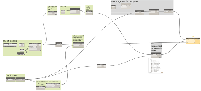

And the new dynamo script, with all headers:
If it helps, I can add the excel and dynamo file as well:
Dörrkort.dyn (32.3 KB) dorrkort.xlsx (10.3 KB)

It feels like I got closer, but not really where I need to be. To make clear what I would like to do now for my 181 doors. I would like to take the list of values by door and apply them for each parameter name. And even better if I could replace all “null” objects in the value list. This is what I’m thinking of:
with something like “-”.

try this.
Thank you!
It works, even though I get an error… No clue why, the data gets copied over :slight_smile:
Dörrkort.dyn (42.0 KB)
As long as everything is copied when I do the whole list of doortypes I’m happy! Thank you for your help!
