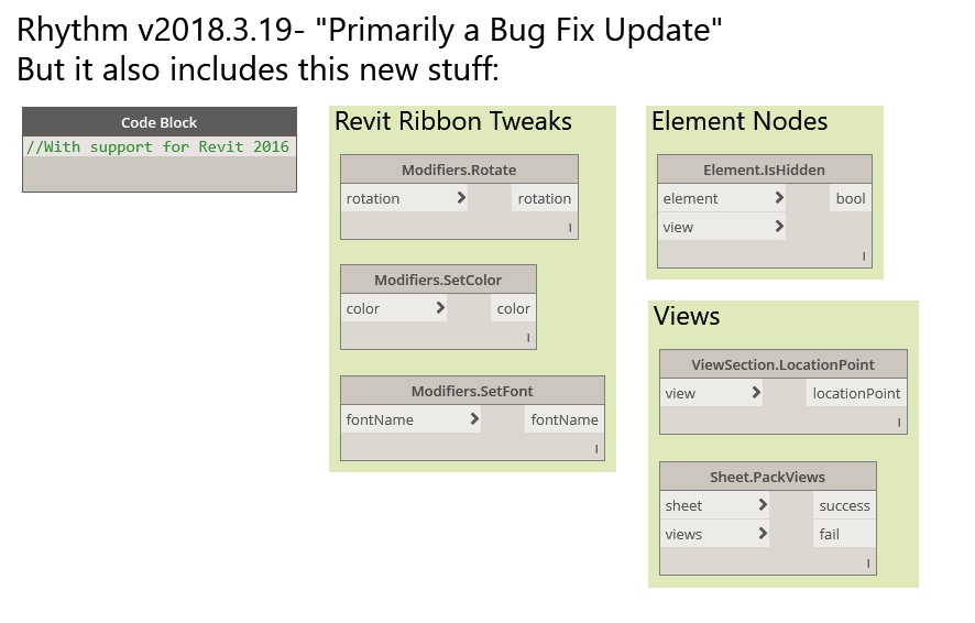

I realize this is an older post, but Rhythm v 2018.3.21 supports Revit 2016+
