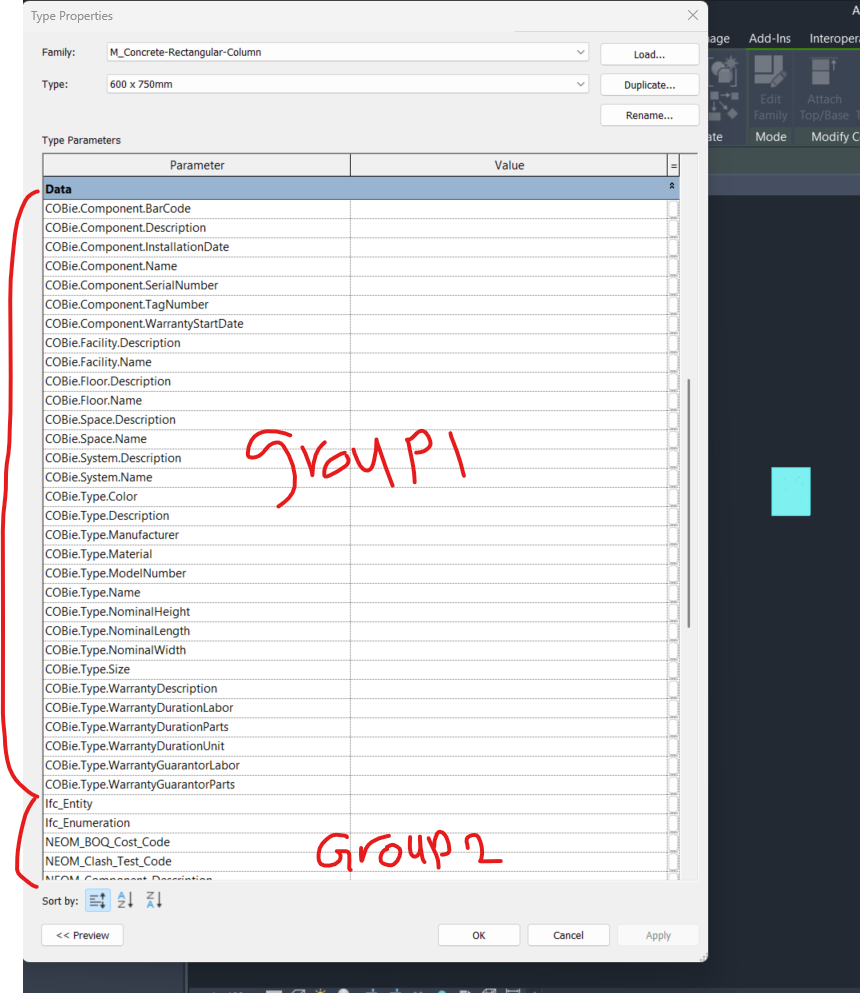

Now i am working on developing a model LOI so my task is to bring all shared parameters from txt file into RVT (and this is piece of cake) then to create project parameters from them foe all model categories and finally updating all parameters values and import them back to Revit
all i could do as per attached to create project parameters for all categories however i am facing a problem in groups like in photos i couldn’t separate them according to txt file.
a quick no brainer is to bind them separately. two parameter lists & two group types. or run → freeze → run.
