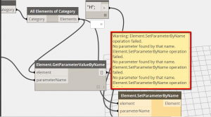

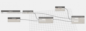

Thanks for the quick reply.
I’ve tried to do the same as you, but it does not work . I do not know what I’m doing wrong. See the picture below.
Hi Salman Pey,
Did you create a parameter called “H” inside your Revit document prior to running the dynamo definition? Unfortunately Dynamo can’t create the parameter on the fly.
I have tried with Project parameters and shared parameters in Revit, none of them is working. Should it be special kind of parameters? I made it with Number and Integer!

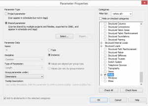

1st create a shared parameter then assign it to walls!

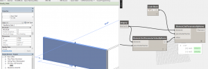

then create a wall and check properties.
you should see an empty parameter H.
“H” should have the same type as “unconnected height” and that is length.
now run dynamo with your definition.
everything runs smoothly
Thank you Peter. It works now.
