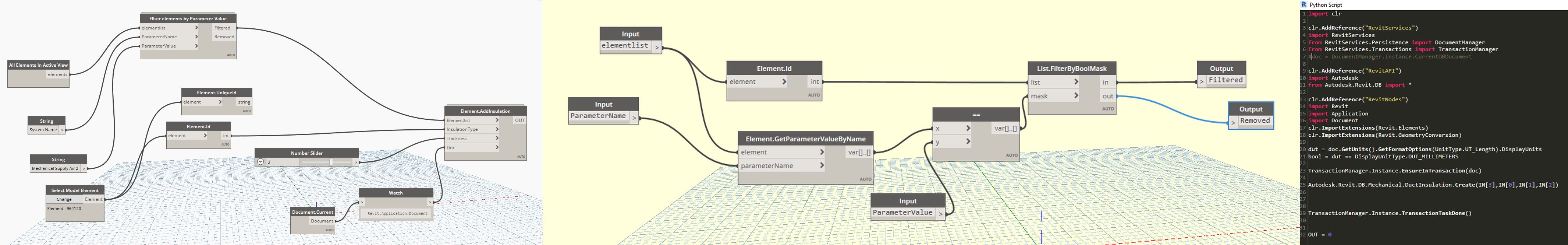

I am trying to insulate Ducts based on their systems but the script run completes without the pipes being insulated at all. I am filtering the IDs and using the Create() method from the RevitAPI
Can anyone see where my issue lies?

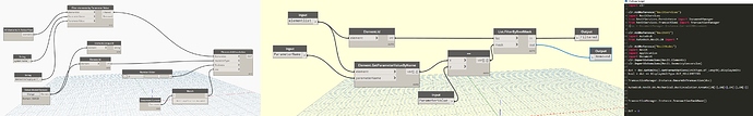

Thank you for the input. That wasn’t the issue, sadly.

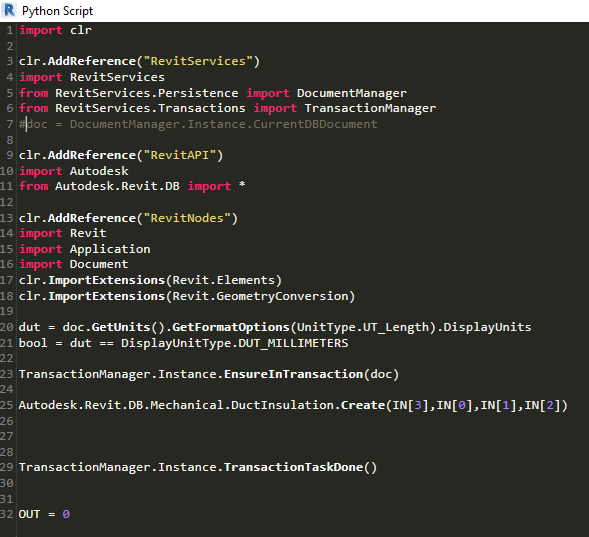

I can see the code is from the MEPover custom node; did that not work like it should? The code you have now will only work for a single element and it will most likely give an error as you are inputting all elements from your active view that belong to a certain system. This could also include mechanical equipment which cannot be insulated. Also the elements need to be unwrapped.
That was the issue. Thank you.
