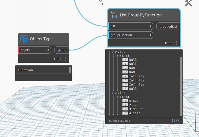

Have you checked your errors? Your code is written for a single list yet you’re supplying a list of sublists.
