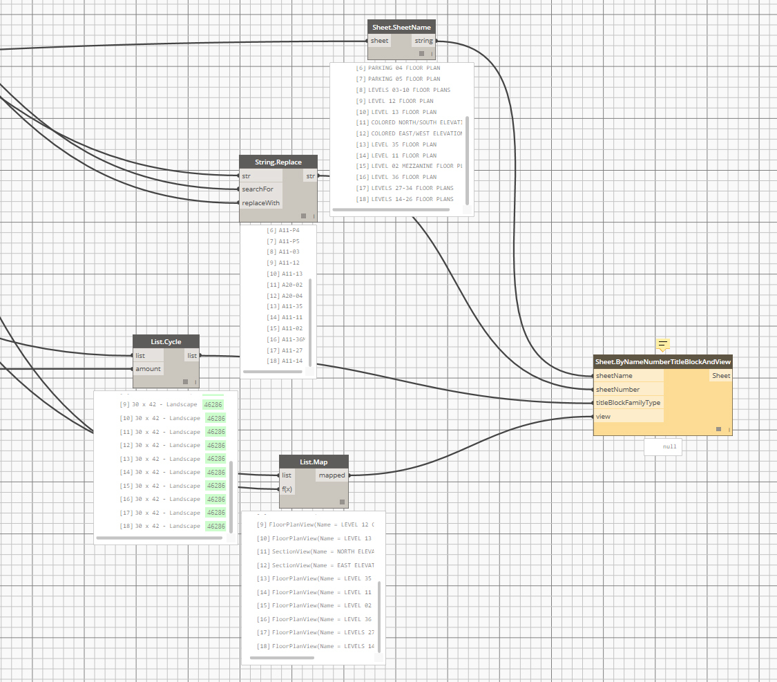

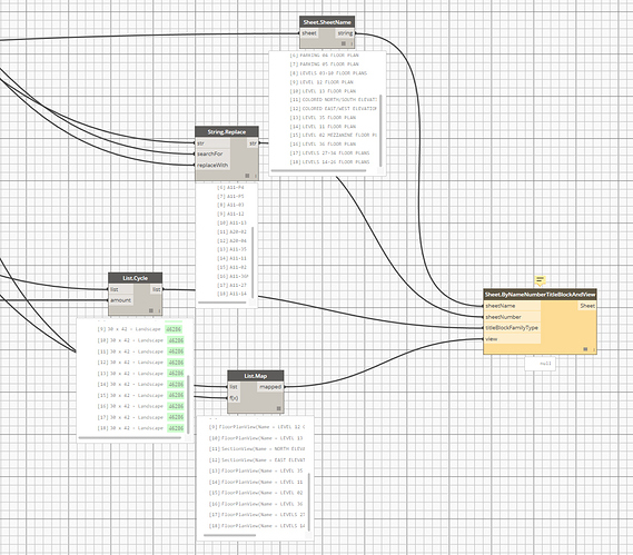

I’m trying to duplicate some sheets and place duplicate views on the newly created sheets. I’ve already duplicated the views and am trying to create the sheets all at once. I have four equal length lists, each corresponding to the correct input but for some reason it isn’t working. Any tips?
Doh…it was because the titleblock input was a collection of family instances instead of the family type. Solved.
