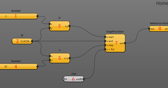

I’ve been struggling with the transaction nodes for a while. I’ve found this article. is quite old but I think that the main focus might be still valid:
I’m trying to debug a big script for rebar creation, and came with the Idea that maybe it is taking too long to process all the data because of the transaction order?.
Well, I’m not familiar of how the transaction node works, so If someone please could explain me if my guess is right or wrong, I’d appreciate it a lot!.

This is indeed old and no longer valid as far as I am aware. We would need a confirmation from the dev team on this.
Do you use manual transactions in your script?
