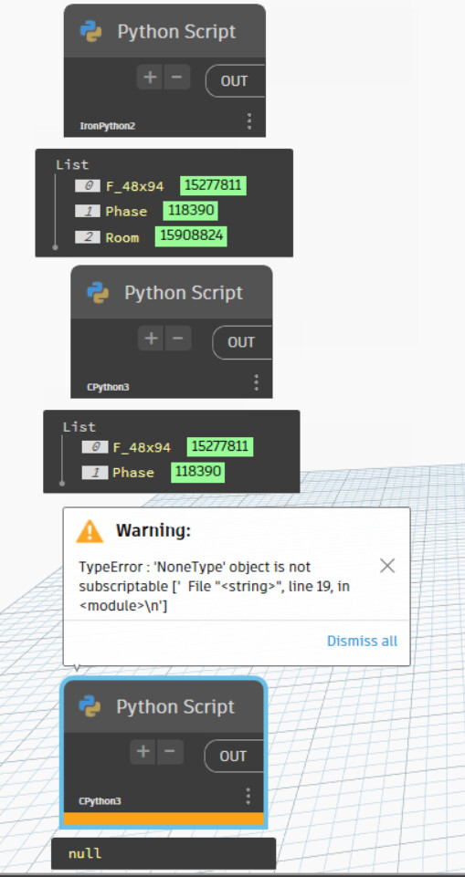

Hi all, I am trying to update a large Python script within Dyanmo from 2.7 to CPython but I cannot get toRoom to work.
I have broken it down to its simplest state. I would appreciate any help that you can provide. I did try the converter button but it said the code was good to go.

All three python nodes have the same code with the exception of the middle one where I turned off toRoom just to prove that the door and phase are still being found. (the top node is 2.7).

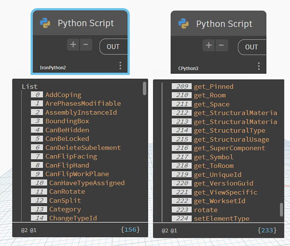

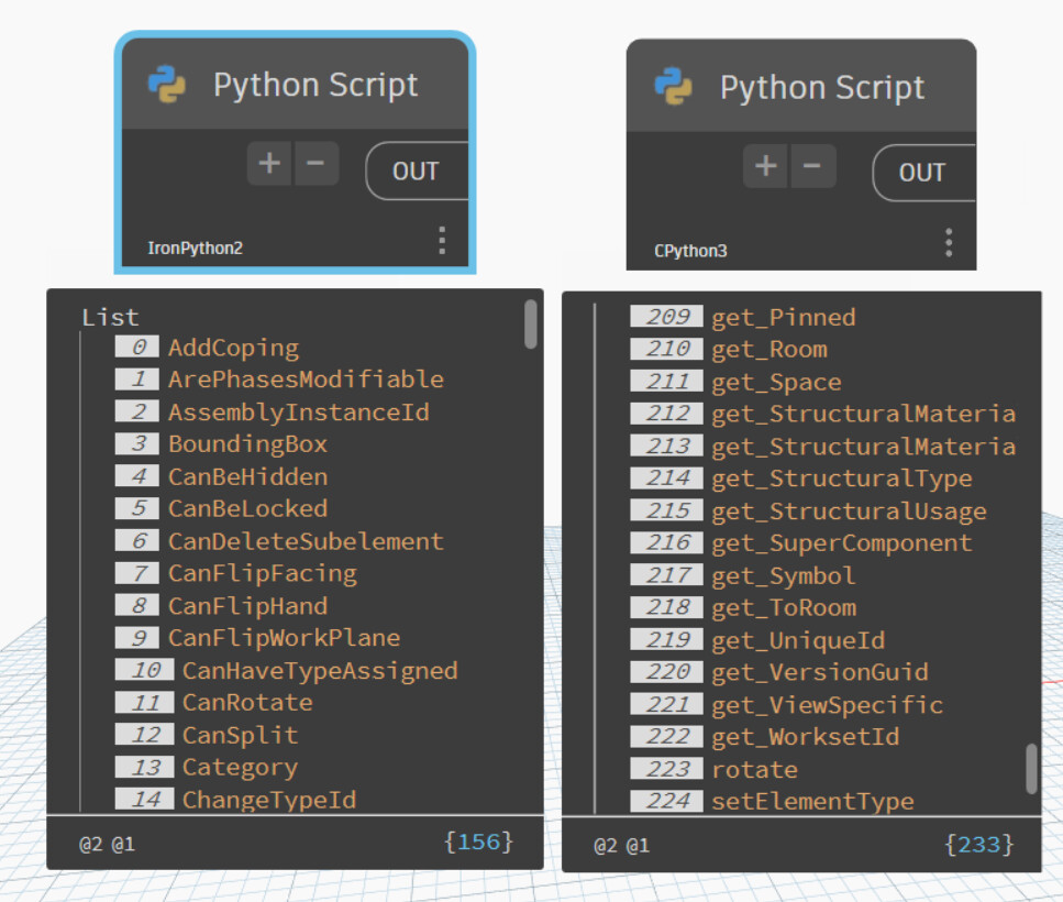

@Mike.Buttery if you do not mind answering one more were did you find .get_ToRoom(phase)? It is not listed under dir or in the API.
I just guessed the overload familyinstance.get_ToRoom(phase) would work and tested it. The method is listed in the dir function - it’s at the end of the list with all the other get_ and set_ methods on a family instance object
Sorry to question you that was my mistake. When I checked the dir list I did it from IronPython2.7. There are a lot more properties that show up when you check it from cPython.
