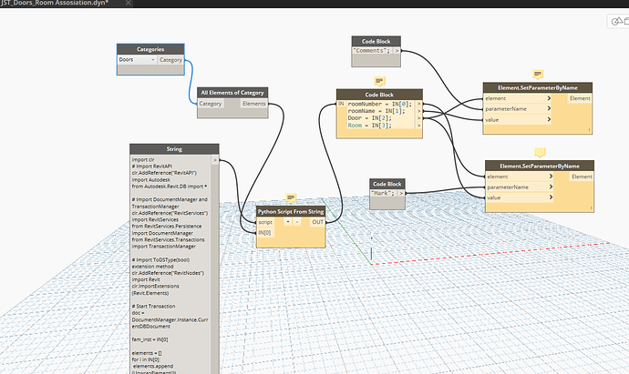

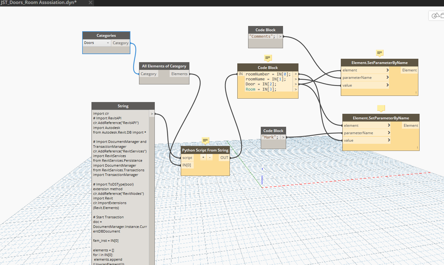

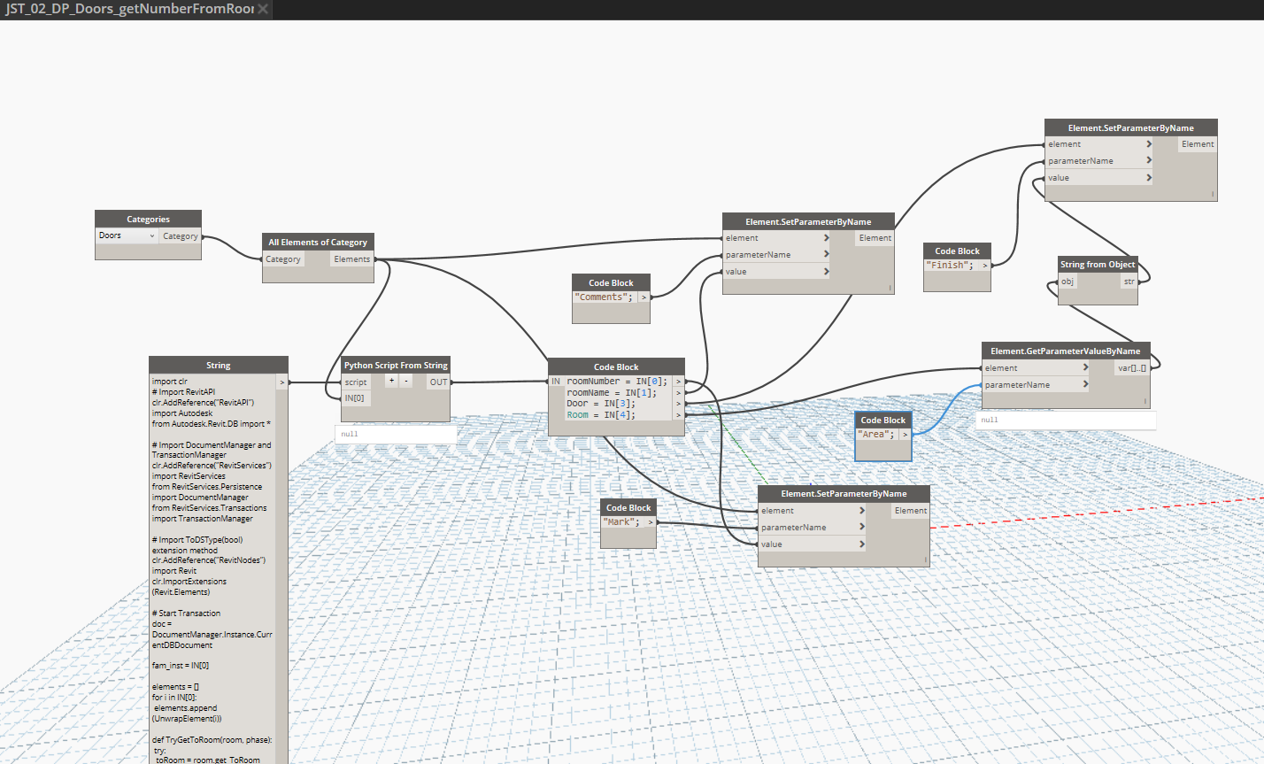

Thanks Jacob for getting me on the right track
As you suggested I made the extension with regular nodes
This is a test where I wrote areas from rooms to finish Doors just to check it worked
