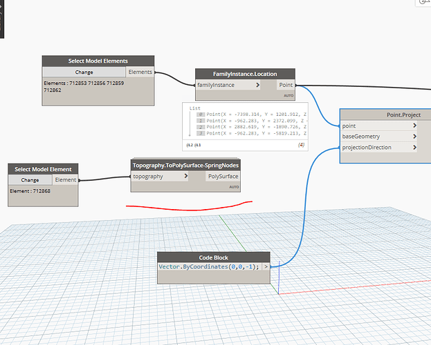

I have to generate a surface from topography and then to align elements.
A script that I found to be useful,
The issue that I face is it keeps crashing as soon as I run the script.
Any suggestions or alternative approach can be useful for me.

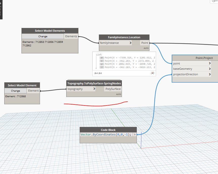

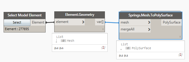

Hi Arun
to get the polysurface you can try this from Springs package
