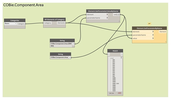

I am really new to Dynamo and I am trying to copy some values from one parameter (COBie.Component.Area (BIM 360)) to another (COBie.Component.Area) . However when I press run and it comes with this message “The parameter’s storage type is not a string”. Any help please ?
use a String.ToNumber from your GetParameter node to the SetParameter node. The Cobie.Component.Area is looking for a Number it sounds like and not a “string” or text value, which is what the GetParameter node must be pulling.
Sean Thanks for getting back on this. Apologies I am new to Dynamo and I am not really getting where should I input the string to number. Could elaborate a bit more please ? Thank you !
Try this.
Thanks Sean it worked for the COBie.Areas but not for the length for some reason.
You haven’t connected the value to the SetParameter Node.
When I do that it comes with the same error as before. “The parameter’s storage type is not a string”
Try this
http://dictionary.dynamobim.com/#/Core/String/Action/String%20from%20Object
or
http://dictionary.dynamobim.com/#/Core/String/Action/ToNumber
The parameter needs to match or you need to convert the data type to receiving parameter.
Ha, simultaneous posting! This is why it is best to only have one post.
