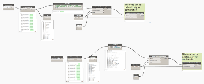

is there a way to access to the label’s parameter in a family. so i can set values to the size and text font ?

thanks for reply, yes this won’t help, i want to edit the text size in the label inside room Tag family

It should be doable but not very straight forward. I’d imagine you’ll have to use the family document open nodes found in Orchid or Rhythm, use a collector on the resulting document file, get the label elements, change their parameters, and re-load the family.
