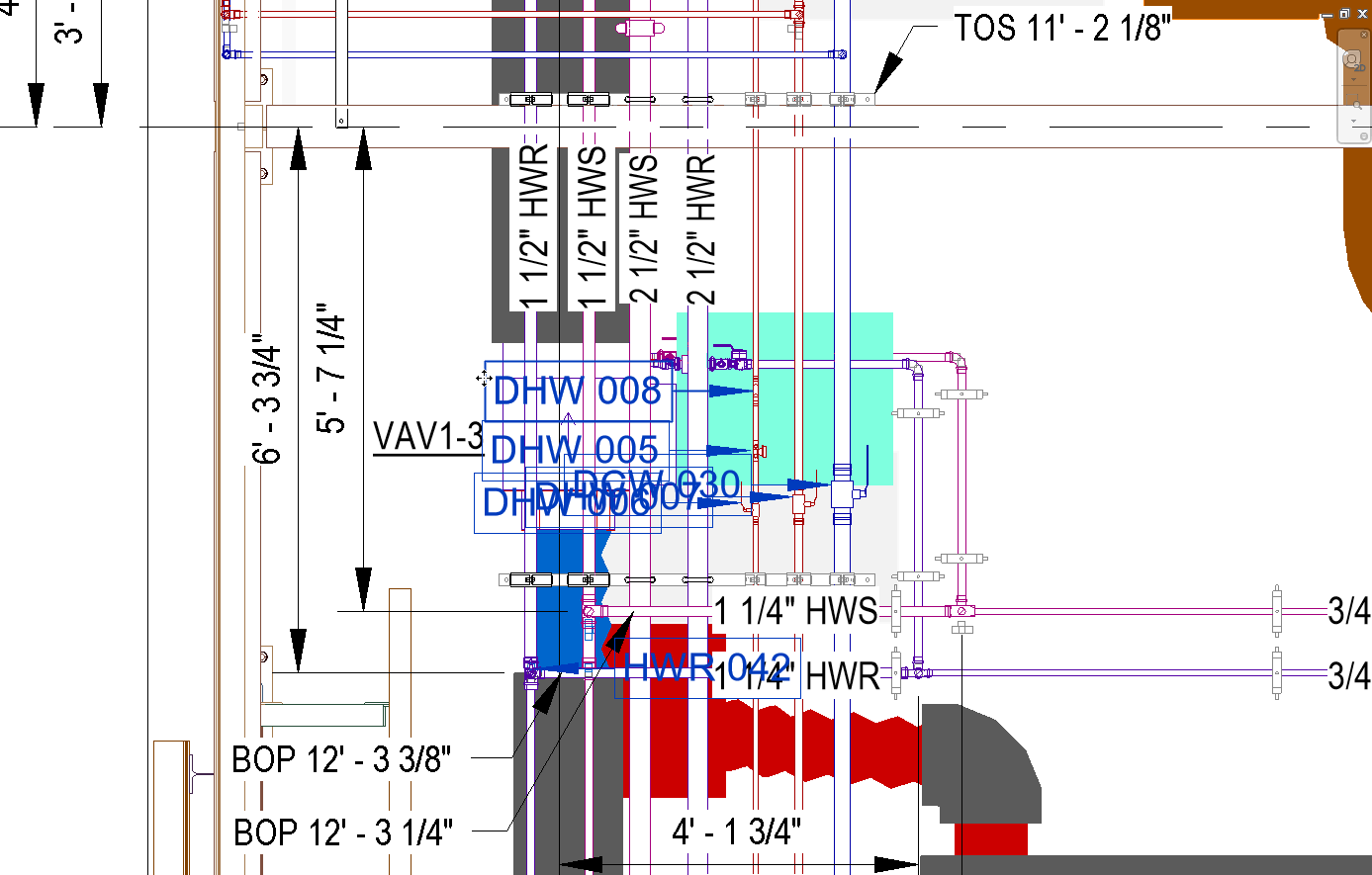

              I tried using… LeaderEndCondition.Attached
When I do… the tags are thrown to the other side of the elements and the Python Script node generates this Warning.
Warning:
IronPythonEvaluator.EvaluateIronPythonScript
operation failed.
  File "<string>", line 40, in <module>
Exception: There is no leader end because the
tag does not use a free end leader.
              I should’ve looked a little more deeply into the rest of the code–maybe the LeaderEndCondition was a bad example. Attached leaders do not report leader ends, according to the documentation, hence the Exception. So, you would be able to change the LeaderEndCondition to Attached, but it would prevent the LeaderEnd property from being accessed.
