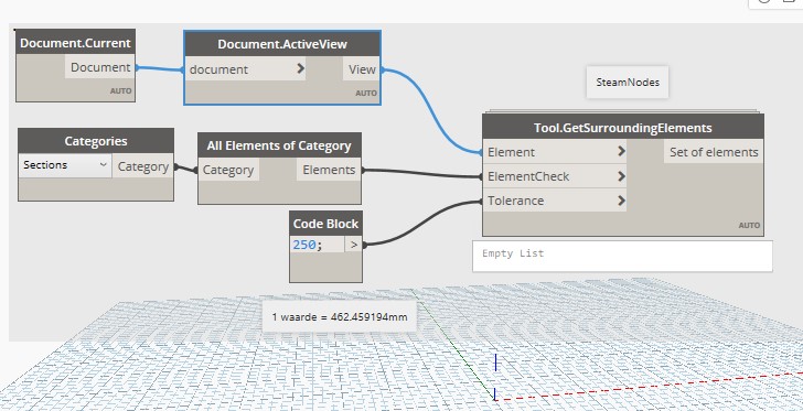

I am trying to get the visible sections in a current view i thought GetSurroundingElements do this, but it doesn’t work with sections or views.
How do i get the visible sections in a current view?

I am not familiar with Python jet, so i tried your code but get error "unexpected token ‘’.
sections
I just tried the code and I can’t get anything out of the sections. Walls, etc. is no problem but sections can’t. Sorry :slight_smile:
to bad thanks anyway
I did try with spring nodes too.
Springs.Collector.ElementsInViews throws an empty list too.
