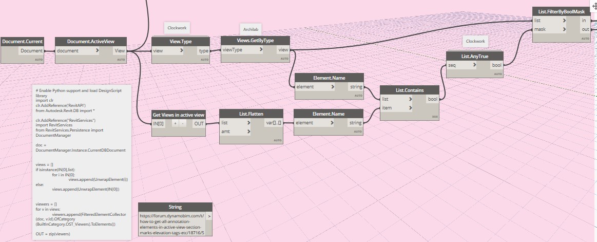

hi,
I made this to retrieve all sections within a view (section).
Enable Python support and load DesignScript library
clr.AddReference(‘RevitAPI’)
clr.AddReference(“RevitServices”)
import RevitServices
views =
if isinstance(IN[0],list):
for i in IN[0]:
views.append(UnwrapElement(i))
else:
views.append(UnwrapElement(IN[0]))
viewers =
for v in views:
viewers.append(FilteredElementCollector(doc, v.Id).OfCategory(BuiltInCategory.OST_Viewers).ToElements())
OUT = zip(viewers)
