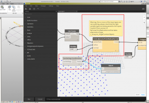

What am I doing wrong here? Why is the sun direction vector not being recognized? If that node is replaced with a Z Axis Vector, the script works.
You’ll need to connect its input to a SunDirection node.
I am using Dynamo 0.7.5.3213., and as far as I can tell, that is the Sun Direction node.
If I am wrong, can you please attach a screen capture of what you are talking about?
Thanks.
Works for me on DynamoInstall0.7.4.20141115T1015.exe
Thanks you Andreas. That Helped. I was some how not finding the .Current node.
It was works now.
