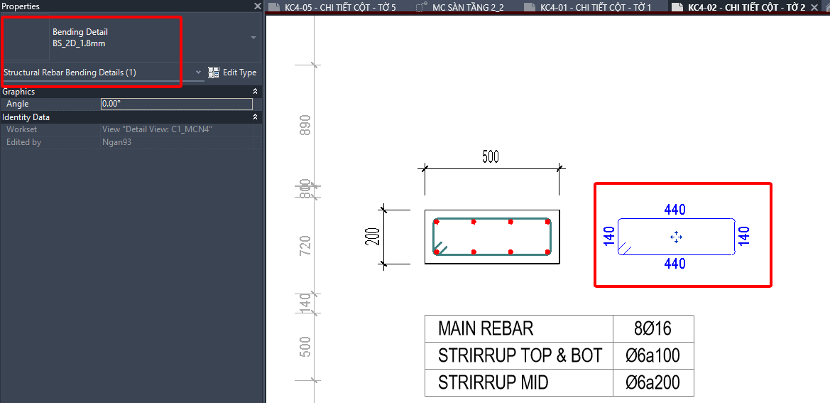

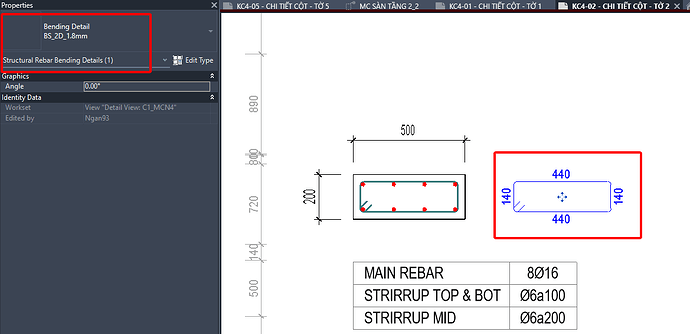

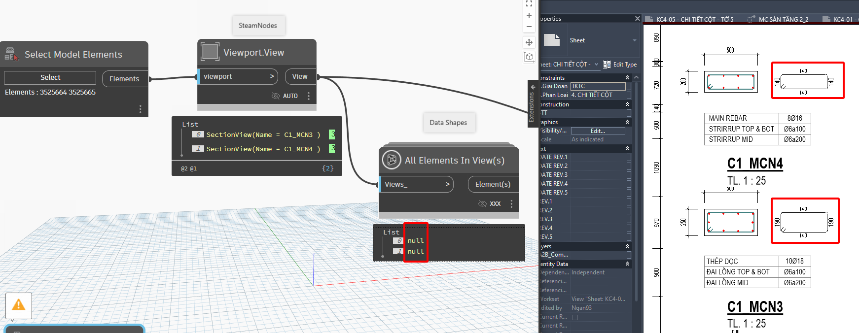

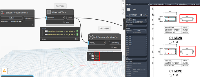

I can’t get the element in the view because the view contains STRUCTURAL REBAR BENDING DETAILS.
I want to get all the elements in the view that contain STRUCTURAL REBAR BENDING DETAILS.

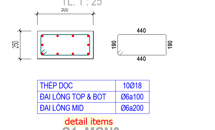

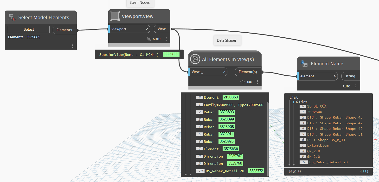

I want to get “detail items” but in the view there is “bending detail” then the “all element in view” node does not work. When I delete “bending detail” then the “all element in view” node works ok as attached image
I want to get the “detail item” that has “bending detail” in the view
if i understand u correctly, either u filter them with some parameter values or some sheet/view level OCR should be in order.
