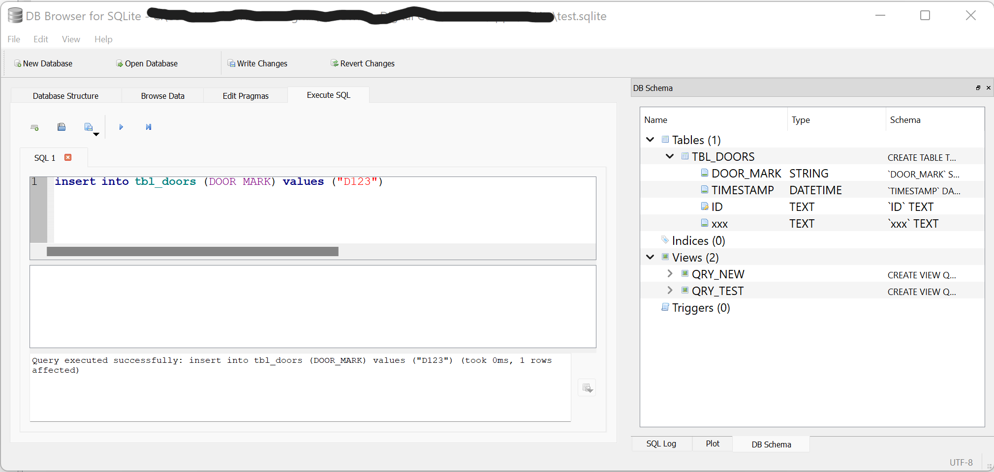

I am able to Query the Data from the SQL but When giving Command to Insert the Data It is showing False
All Type are TEXT for the table

As @SeanP noted- you need to get the concatenation connect- the SQL query string will need quotes around text values- also detailed in the linked post
Should have added- it can be useful to copy/paste the SQL output string from Dynamo into a tool where you can run SQL queries- it may give a meaningful error or help in troubleshooting
