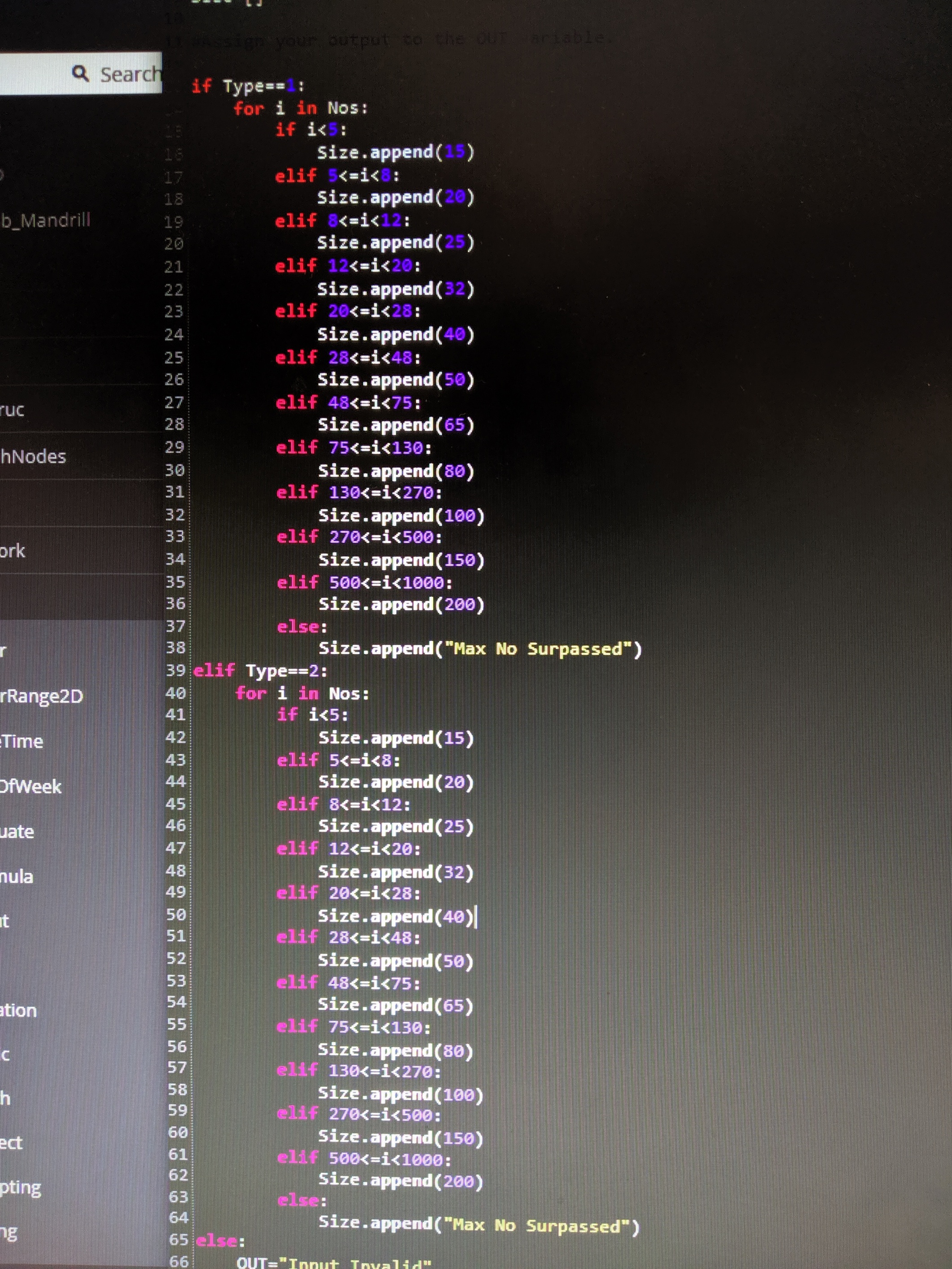

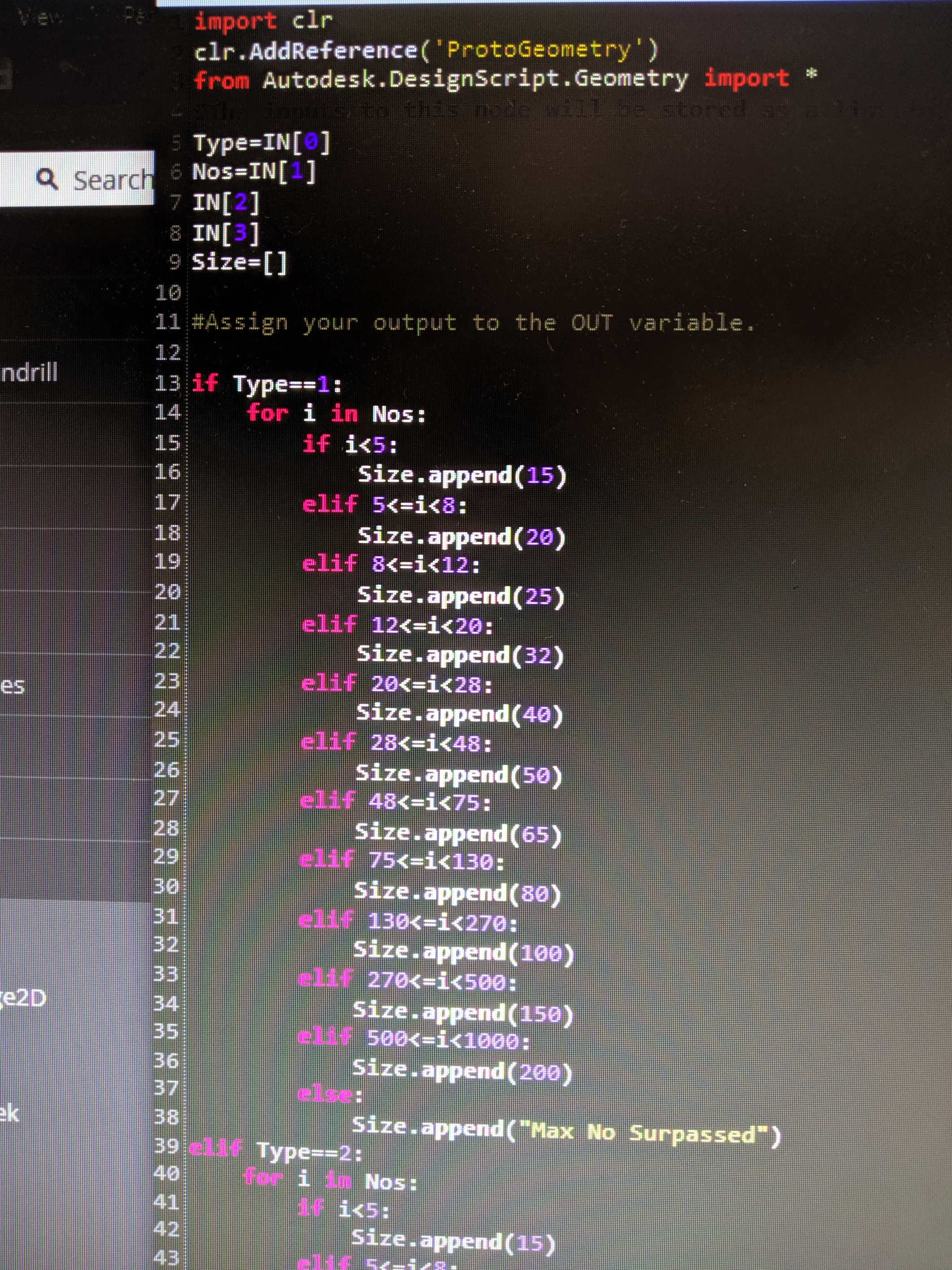

Can you show what the error is that you are getting and a picture of the actual Dynamo graph? Just a picture of the python without seeing any inputs doesn’t let us help you.
if there isen’t another elif loop for the “first” loop (if Type==1 and elif Type==2) you need to use if and else.
So write:
“else Type==2:”
and is can be a problem if you write your data list “Size” to your family parameter and your parameter is only for numbers, because you append “May No Surpassed” to it…and that is a string.
You dont use "IN[2] and IN[3] so you can delete it.
