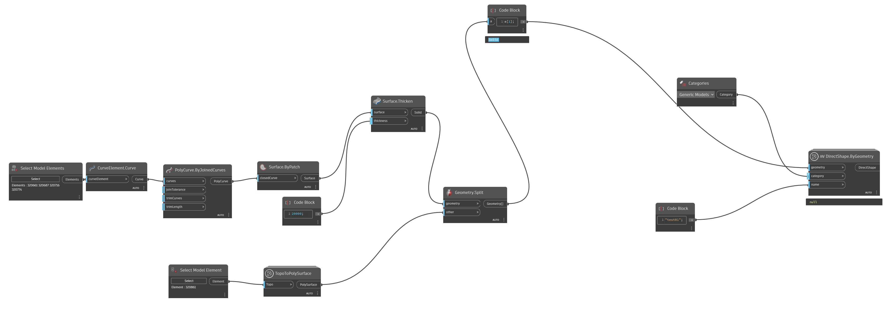

in attached is possible to see the script, it’s very strange i don’t have any errors, but i can’t generate the geometry in revit, in workspace seems that all works good.

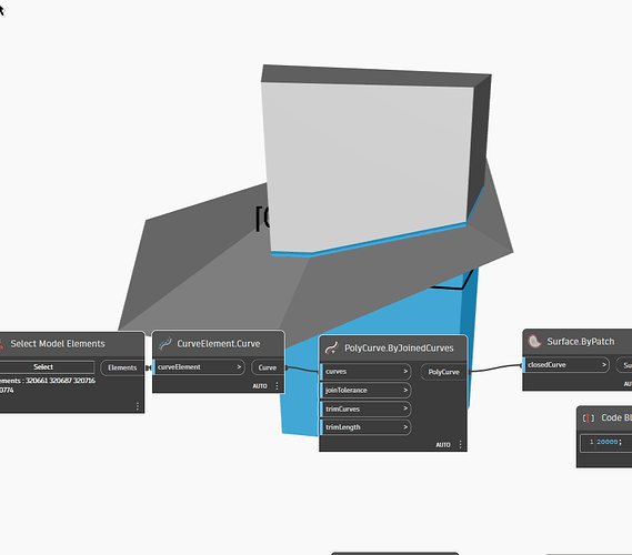

in attached the gemetry in dynamo
Need the source model as well. or rather the model with only elements [320661, 320687, 320716, 320774, 320861] (the elements you extract the curves from and the topo).
My gut says that the topo intersection is generating something which is degenerate, or the coordinates aren’t scaling cleaning during conversion (floating point error).

Feels like the issue is with the Surface.Thicken node, which kind of makes sense as the surfaces might not be pointing in the right direction from a Revit perspective as a result of the process. Using a Curve.ExtrudeAsSolid node makes this work for me.
Working for me.dyn (51.6 KB)
