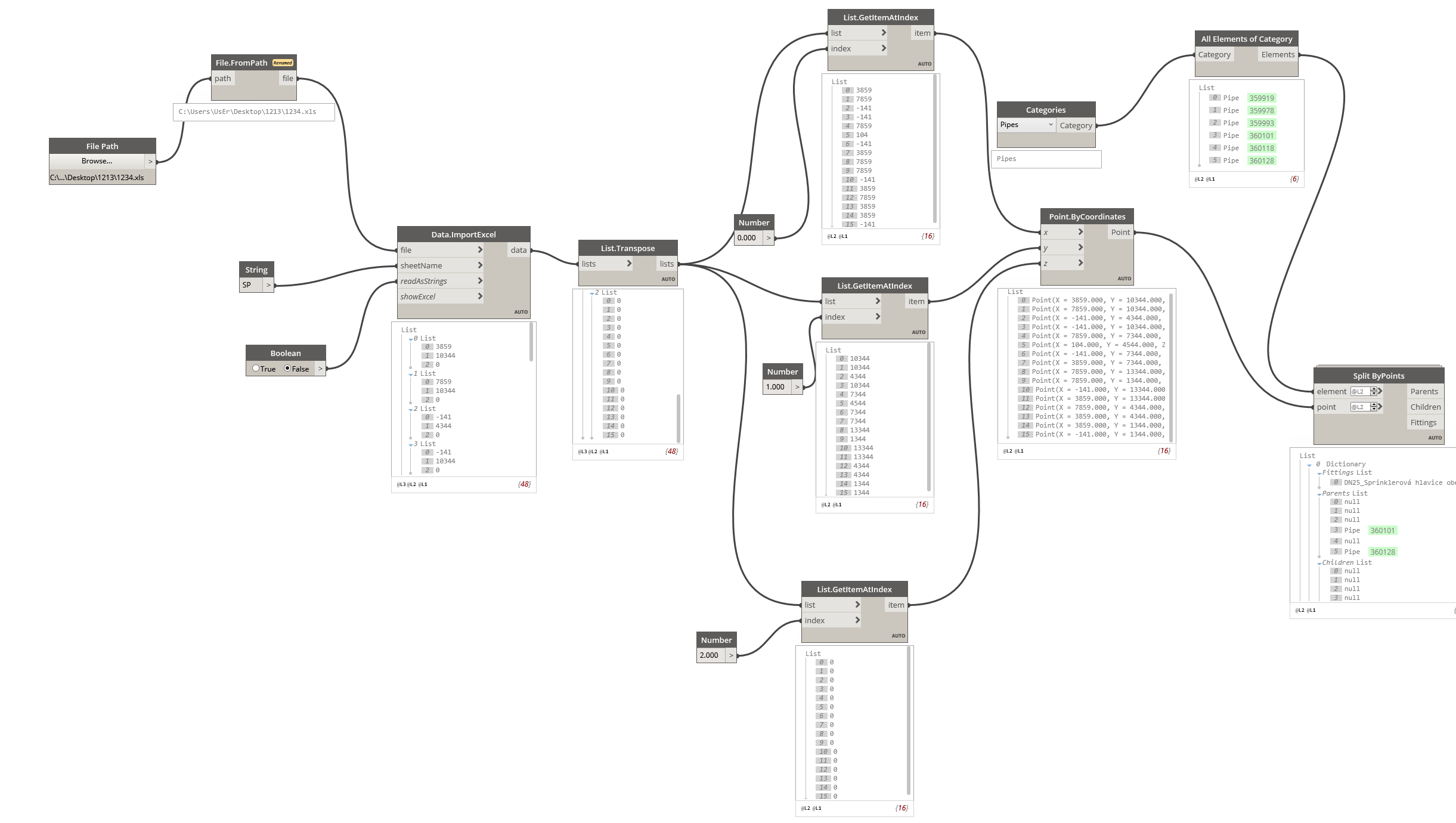

Andreas
Thank you for your response
the workflow run completed Without Errors but it didn’t make the split at the point that i insert it from the Excel in my Revit Model

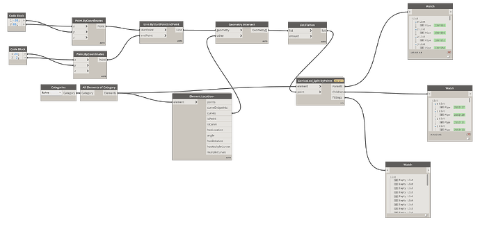

GeniusLoci does the job!
grafik
Thank you for your help, but it didn’t work.

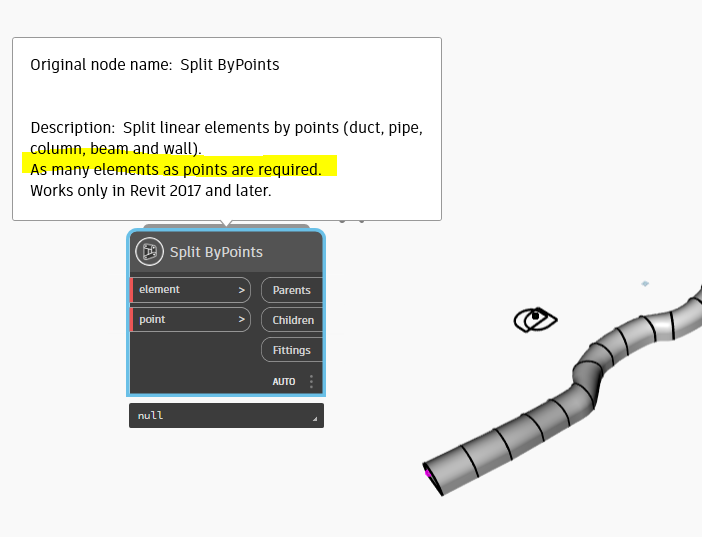

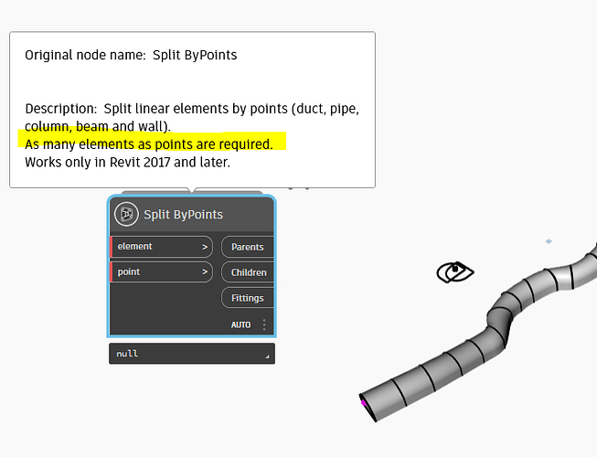

Hello @omaraji585 could something help…

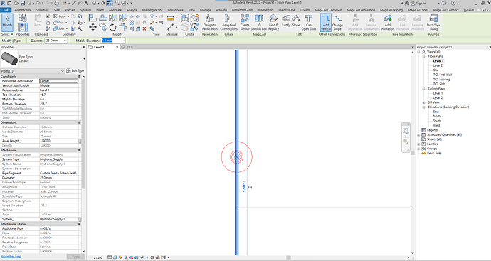

Thank you, but in my Revit model i just have Pips to split and the point is locate in the pip.
may you have an example for this please
Hi Try to take a search here there should be a lof of examples . here is one…

This worked for specific Length 1500 I need it by coordinates Points that I gave it from the excel file
allright do you only have one split pr. pipe ? and how many pipes do you have ? could you show your graph with all nodes expanded
in some point i can see split but not at all point
Hi are you sure these points is on the pipe location line…if not try with closest point to…so you are sure they touch
Hello @omaraji585 I assume you will split each pipe in 16 pieces…if so something could work…
PS if it not what you want or doesnt work then share your files here…just a sample…
Think this is a ‘point has to match the pipe’ issue. In the example dataset provided add a List.Flatten and a List.Shuffle to the points list for an example of what I believe the issue to be.
Yeah agree…he need to find out which pipe the points belong to probably some intersect could help…
