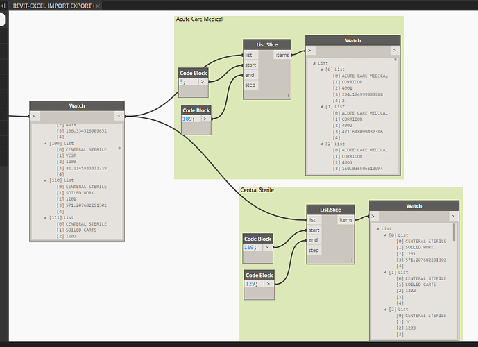

I have created a roundabout way of pulling out data from a List by manually scrolling through the list and telling Dynamo where to cut, If I add or subtract Rooms from my list I have to adjust each of the Code Blocks linked to the List.Slice.
So what I am trying to achieve is more direct/automated way to filter my list. I still want all the info in the same block as the Room I am filtering by but I dont want any of the other types.
Example: If you look in the image below, the left list shows List 110 with Central Sterile under item [0] but it has been sliced from the Right watch list
              This should help convey a possible approach …

But what I am trying to do is separate them into different lists as shown in my image below, what I am trying to improve is instead of manually telling it where i want to slice (the code block and slice list), i want it to slice based on a name or string i give it. That way if i add more rooms i dont have to retype all the code blocks
