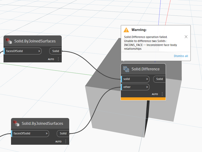

Solid.Difference operation failed. Unable to difference two Solids : INCONS_FACE -- inconsistent face-body relationships
Good evening everyone, I have a problem when I try to use the Solid.Difference tool between two solids
These are the nodes that generate the code:
On purpose I am extracting the boundingBox from these cuboids, converting them to polySurface and then using solid.ByjoinedSurfaces. I would need to convert polySurfaces to solids to simulate a similar situation where I’m having the same problem

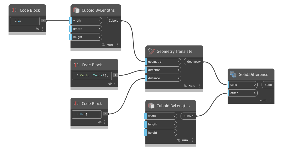

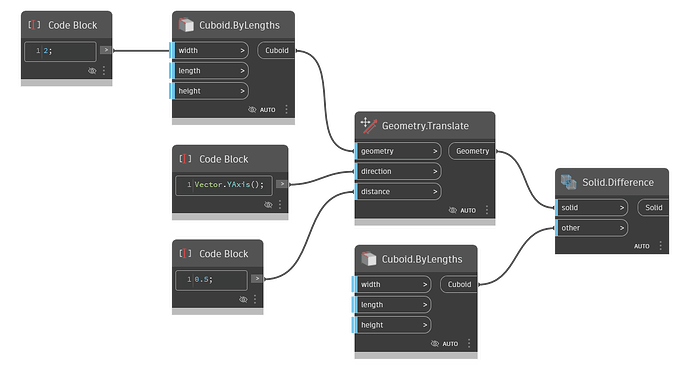

When I simply connect the cuboids in the solid.Difference function this works perfectly for what I want:

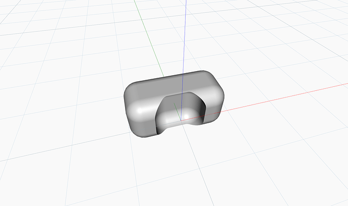

Interestingly when I apply fillets to these solid.ByJoinedSurfaces they work the solid.Difference operation

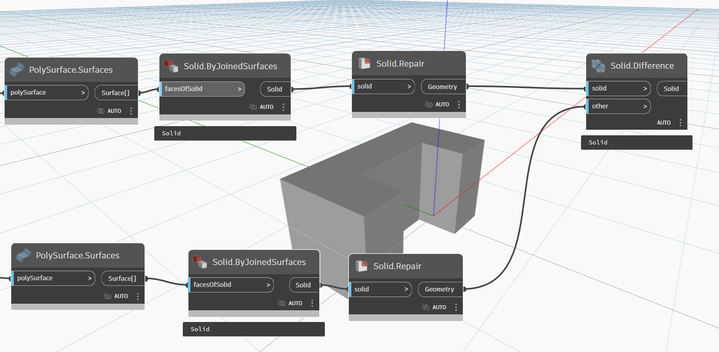

Hello @andraderenan951 and welcome to the forum, could solid repair work for you ?
Does this tool exist in the Dynamo version of Alias? Because I didn’t find it in my library, nor when searching in the menu
not sure i had tried in dynamo revit 2024 dont know Alias, probably its only for newer version, do you have polysurface.extractsolids node , it should work as wel
Just for your information, you have to be on Alias 2024.0 or 2024.1 to have Solid.Repair available to you.
