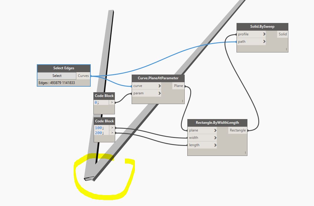

I want to make a solid along a selected edge what is working now.
But how can you make the solid at the corner closed?
Try to join the edges into one polycurve with the polycurve.byjoinedcurves node.
Thanks!
At the moment of your replay i found that node. So i was a little bit to fast
